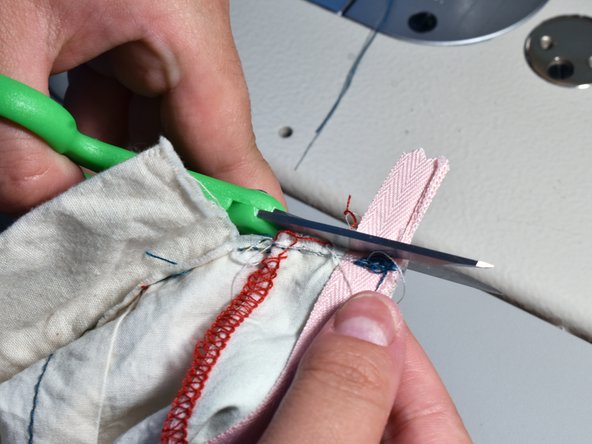

  2. Replacing an Invisible Zipper: crwdns2935265:02crwdnd2935265:01crwdnd2935265:03crwdne2935265:0 Replacing an Invisible Zipper: crwdns2935265:02crwdnd2935265:02crwdnd2935265:03crwdne2935265:0 Replacing an Invisible Zipper: crwdns2935265:02crwdnd2935265:03crwdnd2935265:03crwdne2935265:0
    • Locate the stitch lines of where the broken zipper was sewn on both sides of your garment.
    • Use a seam ripper to carefully rip out both of the stitching lines.
    • How to Rip a Seam
    • Make sure to not cut through the fabric.
    • Remove old invisible zipper.

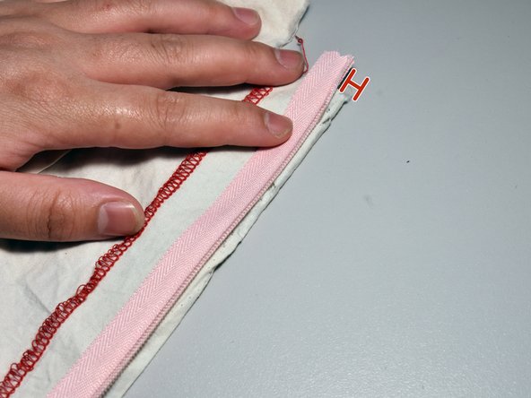

  3. Replacing an Invisible Zipper: crwdns2935265:03crwdnd2935265:01crwdnd2935265:02crwdne2935265:0 Replacing an Invisible Zipper: crwdns2935265:03crwdnd2935265:02crwdnd2935265:02crwdne2935265:0
    • Turn the skirt inside out.
    • Place the replacement invisible zipper on the table, with the teeth side pointing up and the zipper pull facing down.
    • Unzip the invisible zipper. Line up the left side of the tape of the invisible zipper with the left side of your fabric.
    • The zipper teeth should 1/8" away from the edge of the fabric.

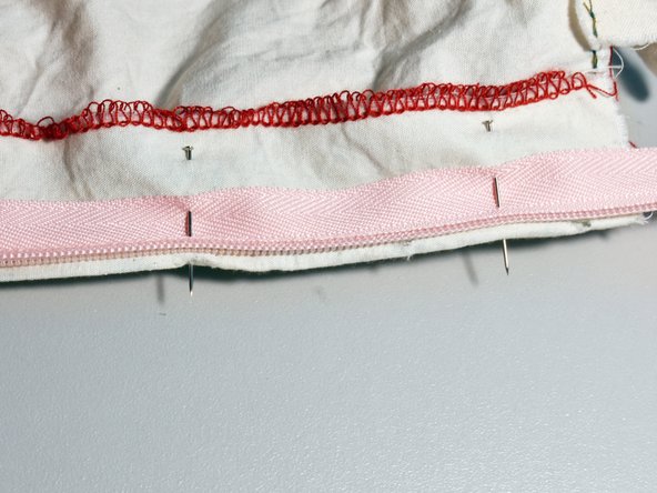

  4. Replacing an Invisible Zipper: crwdns2935265:04crwdnd2935265:01crwdnd2935265:02crwdne2935265:0 Replacing an Invisible Zipper: crwdns2935265:04crwdnd2935265:02crwdnd2935265:02crwdne2935265:0
    • Pin the tape of the zipper to your garment's fabric perpendicular to the invisible zipper.

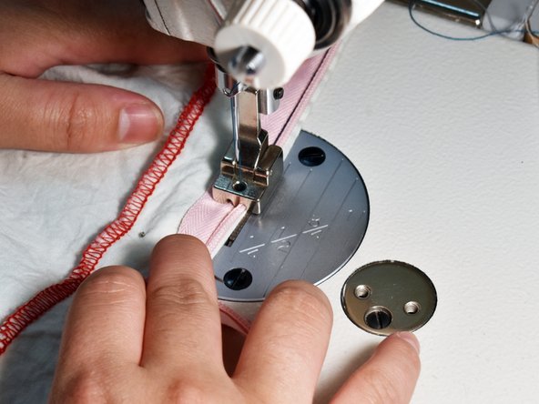

  5. Replacing an Invisible Zipper: crwdns2935265:05crwdnd2935265:01crwdnd2935265:02crwdne2935265:0 Replacing an Invisible Zipper: crwdns2935265:05crwdnd2935265:02crwdnd2935265:02crwdne2935265:0
    • Place the teeth of the left side of the zipper into the right side of the invisible zipper foot.
    • When repeating on the opposite side of the zipper, place the teeth of the right side of the zipper on the left side of the invisible zipper foot.

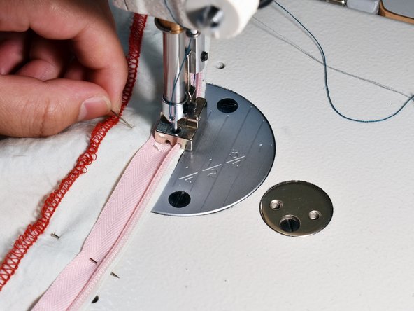

  6. Replacing an Invisible Zipper: crwdns2935265:06crwdnd2935265:01crwdnd2935265:03crwdne2935265:0 Replacing an Invisible Zipper: crwdns2935265:06crwdnd2935265:02crwdnd2935265:03crwdne2935265:0 Replacing an Invisible Zipper: crwdns2935265:06crwdnd2935265:03crwdnd2935265:03crwdne2935265:0
    • Sew a straight line carefully, removing pins as you go.
    • Repeat Steps 5-8 on the right side of your garment.

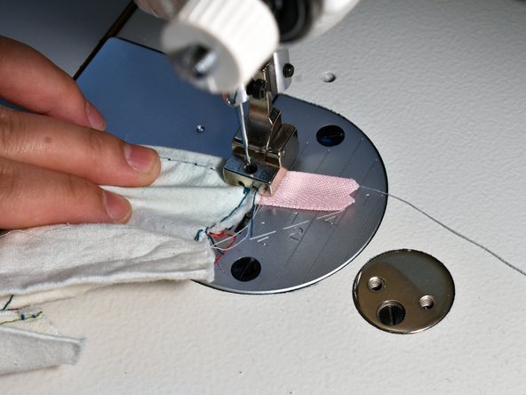

  7. Replacing an Invisible Zipper: crwdns2935265:07crwdnd2935265:01crwdnd2935265:03crwdne2935265:0 Replacing an Invisible Zipper: crwdns2935265:07crwdnd2935265:02crwdnd2935265:03crwdne2935265:0 Replacing an Invisible Zipper: crwdns2935265:07crwdnd2935265:03crwdnd2935265:03crwdne2935265:0
    • Turn the skirt right-side out again, so you don't see the zipper teeth.
    • Rotate the fabric so the zipper foot is perpendicular to the zipper tape.
    • Position the zipper foot on top of the fabric 1/8th of an inch from where the zipper tape meets the garment.
    • Sew back and forth at least 6 times to seal the end.
    • This ensures that the zipper tab does not come off when you zip it up.
    • Flip garment over to see the stitch line you just made. Cut off excess zipper tape.

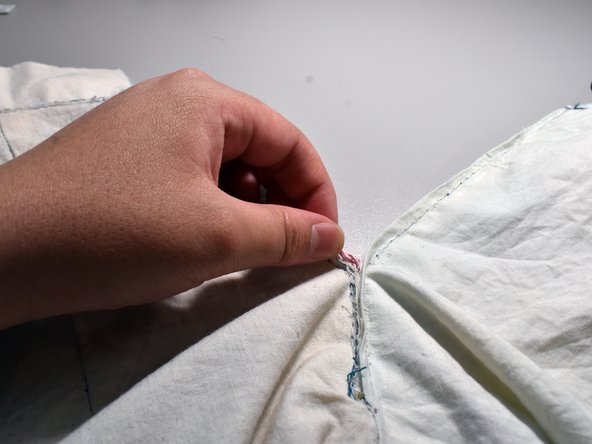

  8. Replacing an Invisible Zipper: crwdns2935265:08crwdnd2935265:01crwdnd2935265:03crwdne2935265:0 Replacing an Invisible Zipper: crwdns2935265:08crwdnd2935265:02crwdnd2935265:03crwdne2935265:0 Replacing an Invisible Zipper: crwdns2935265:08crwdnd2935265:03crwdnd2935265:03crwdne2935265:0
    • Pull up your newly replaced zipper.
    • Be proud of yourself! You've just replaced an invisible zipper!
