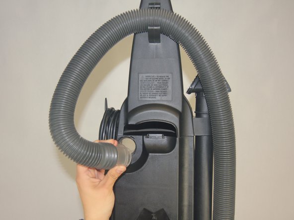

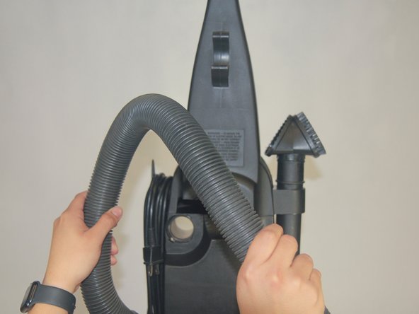

    • Remove the single 4 mm Phillips screw that attaches the lower hose to the machine.

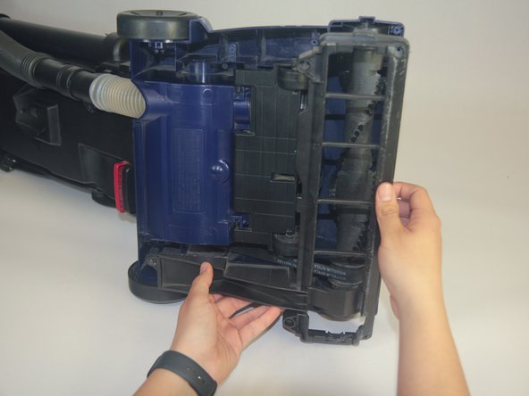

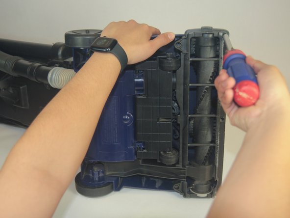

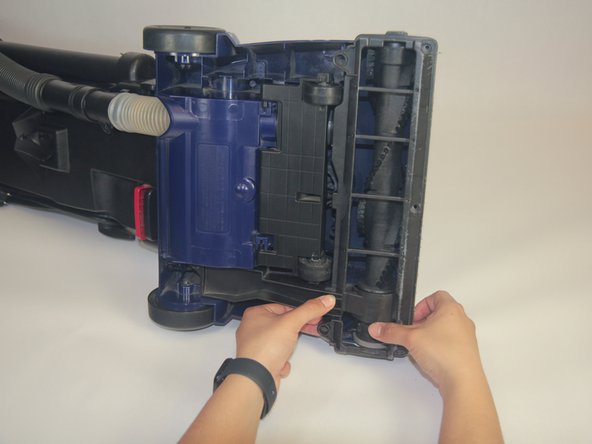

    • Remove the six 4 mm Phillips screws that secure the access plate.
  4. Replacing a Bissell POWERforce Helix Vacuum Hose: crwdns2935265:04crwdnd2935265:01crwdnd2935265:03crwdne2935265:0 Replacing a Bissell POWERforce Helix Vacuum Hose: crwdns2935265:04crwdnd2935265:02crwdnd2935265:03crwdne2935265:0 Replacing a Bissell POWERforce Helix Vacuum Hose: crwdns2935265:04crwdnd2935265:03crwdnd2935265:03crwdne2935265:0
    • Unclip the access plate from the top and bottom.
    • Remove the access plate.

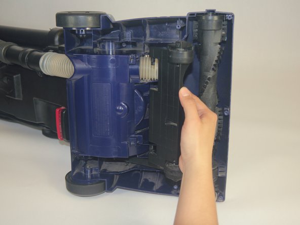

  5. Replacing a Bissell POWERforce Helix Vacuum Hose: crwdns2935265:05crwdnd2935265:01crwdnd2935265:02crwdne2935265:0 Replacing a Bissell POWERforce Helix Vacuum Hose: crwdns2935265:05crwdnd2935265:02crwdnd2935265:02crwdne2935265:0
    • Lift up the roller assembly and pull it out towards you.

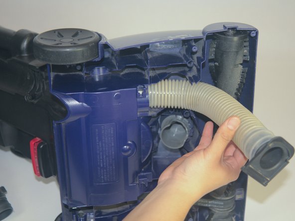

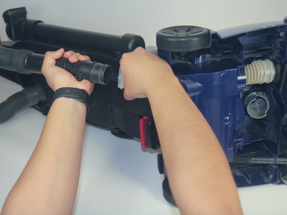

    • Detach the black upper hose from the clear lower hose.
  7. Replacing a Bissell POWERforce Helix Vacuum Hose: crwdns2935265:07crwdnd2935265:01crwdnd2935265:03crwdne2935265:0 Replacing a Bissell POWERforce Helix Vacuum Hose: crwdns2935265:07crwdnd2935265:02crwdnd2935265:03crwdne2935265:0 Replacing a Bissell POWERforce Helix Vacuum Hose: crwdns2935265:07crwdnd2935265:03crwdnd2935265:03crwdne2935265:0

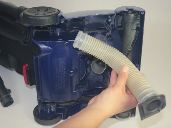

    • Remove the lower hose.
  8. Replacing a Bissell POWERforce Helix Vacuum Hose: crwdns2935265:08crwdnd2935265:01crwdnd2935265:03crwdne2935265:0 Replacing a Bissell POWERforce Helix Vacuum Hose: crwdns2935265:08crwdnd2935265:02crwdnd2935265:03crwdne2935265:0 Replacing a Bissell POWERforce Helix Vacuum Hose: crwdns2935265:08crwdnd2935265:03crwdnd2935265:03crwdne2935265:0
    • Detach the upper hose from the machine.
