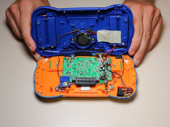

      • Using a plastic opening tool, separate the two pieces of the case carefully.
    1. Replacing VTech MobiGo Touch Learning System Speaker, Speaker: crwdns2935265:04crwdnd2935265:01crwdnd2935265:02crwdne2935265:0 Replacing VTech MobiGo Touch Learning System Speaker, Speaker: crwdns2935265:04crwdnd2935265:02crwdnd2935265:02crwdne2935265:0
      • The speaker will be attached to the back of the case.

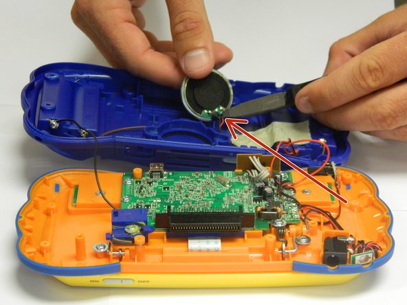

      • Lift the round speaker with a plastic opening tool.
      • Remove the two wires connected to the speaker.
      • You can use wire cutters or regular needle nose pliers to disconnect the wires from the speaker.
      • Once the wires are disconnected, remove the speaker from the back of the case.

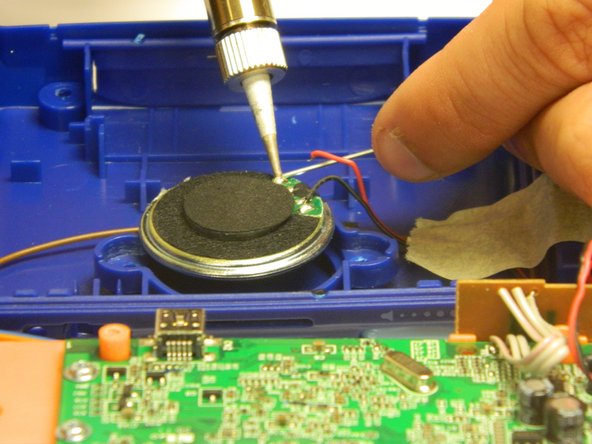

      • Solder the wires to the appropriate spots on the new speaker, making sure that both wires are properly connected.
      • The wires may be hot.

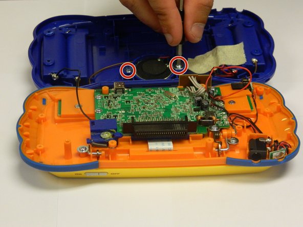

      • Insert the new speaker into the hatch located in the middle part of the panel using a plastic spudger.
      • Make sure the speaker is the right size for the panel.
      • Once the speaker is properly placed, screw in the two 6.0 mm Philips J0 screws.
      • Do not over tighten the screws or the panel will break.
