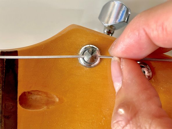

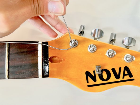

    • Use a string winder to loosen each string by turning the peg counter-clockwise.
    • Once loosened, pull the string out of the tuning peg.

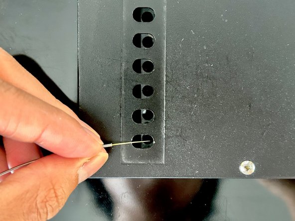

    • Move to the bridge of the guitar and push the strings through.
    • Flip the guitar around and pull the string out of the hole in the back.
  3. Replacing Strings on Floating Tremolo Bridge Guitar: crwdns2935265:03crwdnd2935265:01crwdnd2935265:02crwdne2935265:0 Replacing Strings on Floating Tremolo Bridge Guitar: crwdns2935265:03crwdnd2935265:02crwdnd2935265:02crwdne2935265:0
    • Insert the new strings through the holes in the back.
    • Many strings will be color coded or have guides so you'll know which holes to put each string through.
    • Feed the string through to the other end and pull until the end of the string is reached.
    • You will know if you reached the end of the string if you can't pull any further.

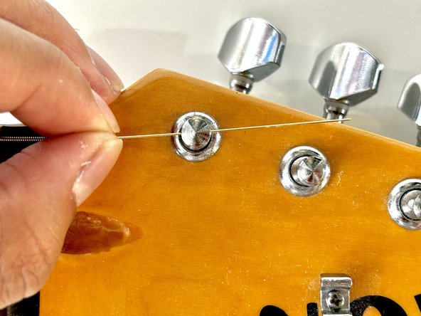

    • Turn each tuning peg until the holes are perpendicular to the nut.
    • The nut is the piece of wood with grooves that hold the strings.

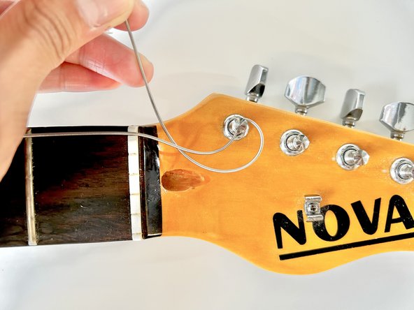

    • Align each string to the groove in the nut.
    • Insert the strings into the corresponding tuning peg.
    • Leave about an inch or 2 of slack.
  6. Replacing Strings on Floating Tremolo Bridge Guitar: crwdns2935265:06crwdnd2935265:01crwdnd2935265:03crwdne2935265:0 Replacing Strings on Floating Tremolo Bridge Guitar: crwdns2935265:06crwdnd2935265:02crwdnd2935265:03crwdne2935265:0 Replacing Strings on Floating Tremolo Bridge Guitar: crwdns2935265:06crwdnd2935265:03crwdnd2935265:03crwdne2935265:0
    • To tie the knot, begin by looping the string around and then under.
    • Pull up on the string until you can feel tension.
    • Loop the string over and pull.
