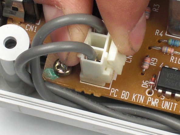

  5. Replacing Sega Dreamcast Power Block (Power Supply), Power Block (Power Supply): crwdns2935265:05crwdnd2935265:01crwdnd2935265:02crwdne2935265:0 Replacing Sega Dreamcast Power Block (Power Supply), Power Block (Power Supply): crwdns2935265:05crwdnd2935265:02crwdnd2935265:02crwdne2935265:0
    • Verify that the console is disconnected from the AC outlet before you begin. If you have just powered off the system, give the capacitors a few minutes to discharge before you begin working.
    • Remove the white female pin header by clamping the clip and pulling it up gently from the power board.

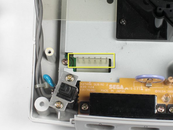

    • Do not bend the male pin header between the mounted head when you remove the power supply from the chassis.
    • Remove the power board by using both hands to gently lift the power board away from the console.
