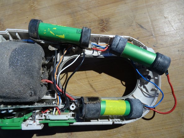

    • The batteries - shown here in green - are easy to see. They are held in the device by rubber buffers.

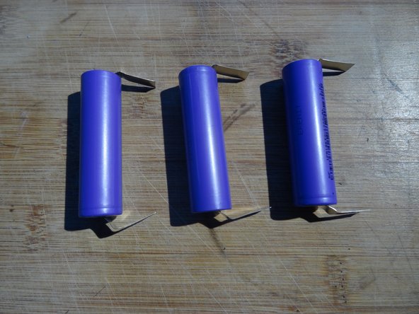

    • You need three 18650 batteries with U-shaped solder tabs. The higher the capacity, the longer you can vacuum. Use types with a nominal voltage of 3.7 V and a charging voltage of 4.1 V.
    • To be on the safe side, measure the voltage of each cell. They should all be the same.

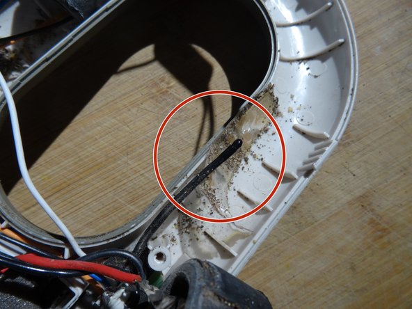

    • Carefully lift out the batteries. A fuse and a thermal sensor are glued to the first and third battery.
    • Remove the adhesive tapes and carefully push the fuse and the thermal sensor to the side.
    • In the third picture you can see the thermal sensor. Note how it is guided through a groove in the rubber buffer and rests against the battery.

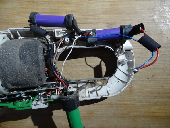

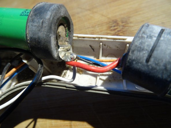

    • All solder joints are secured with heat-shrink tubing. Cut all heat-shrink tubing with a sharp tool and remove it.
  7. Replacing Philips FC 6148 handheld vacuum cleaner batteries: crwdns2935265:07crwdnd2935265:01crwdnd2935265:02crwdne2935265:0 Replacing Philips FC 6148 handheld vacuum cleaner batteries: crwdns2935265:07crwdnd2935265:02crwdnd2935265:02crwdne2935265:0
    • Now comes the main work: soldering. Get some wide heat-shrink tubing that fits over the soldering tabs.
    • Desolder the old batteries piece by piece - you can also pinch off the cables - and solder them to the new batteries in the same way:
    • Slide on suitable pieces of heat-shrink tubing before soldering.
    • Pay very close attention to the polarity of the batteries. If you make a mistake here, nothing will work!
    • Heat the heat-shrink tubing until it tightens against the soldering tabs.
