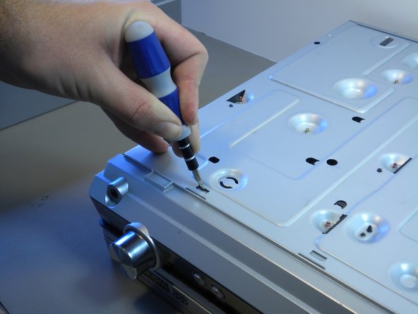

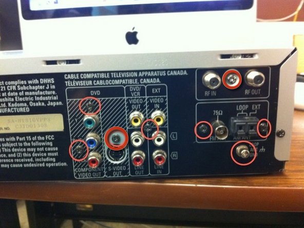

    • With the front display of the device facing you, rotate the device 90 degrees counter clockwise.
    • Remove silver screw and then turn the device 180 degrees. Remove the second silver screw.

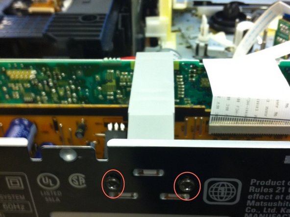

  2. Replacing Panasonic SA-HT810V New Screen, Motherboard, and Power Supply: crwdns2935265:02crwdnd2935265:01crwdnd2935265:01crwdne2935265:0
    • Rotate the device so that the back faces you.
    • Locate and remove the two side screws shown in the image.
  3. Replacing Panasonic SA-HT810V New Screen, Motherboard, and Power Supply: crwdns2935265:03crwdnd2935265:01crwdnd2935265:01crwdne2935265:0
    • To remove silver cover, pull the sides out and up.

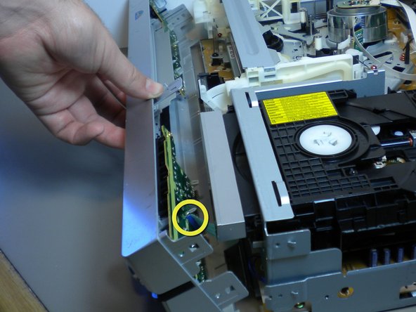

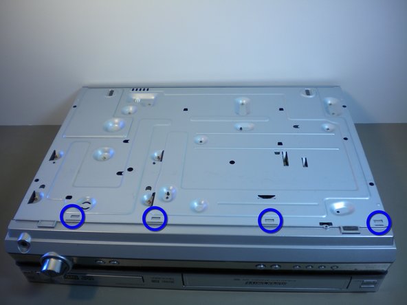

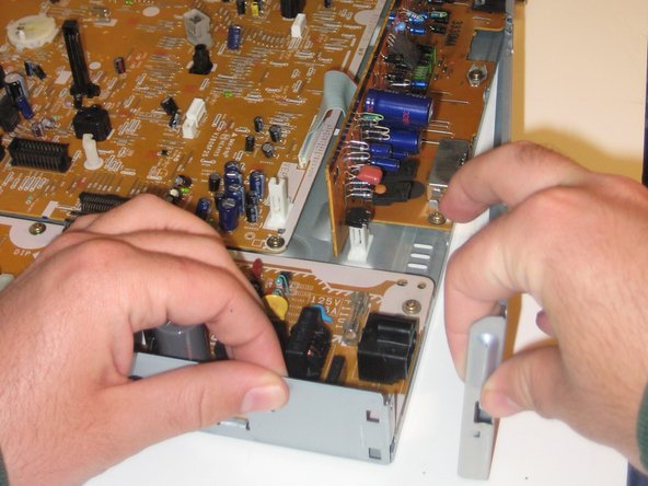

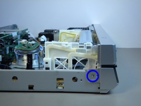

  4. Replacing Panasonic SA-HT810V New Screen, Motherboard, and Power Supply: crwdns2935265:04crwdnd2935265:01crwdnd2935265:03crwdne2935265:0 Replacing Panasonic SA-HT810V New Screen, Motherboard, and Power Supply: crwdns2935265:04crwdnd2935265:02crwdnd2935265:03crwdne2935265:0 Replacing Panasonic SA-HT810V New Screen, Motherboard, and Power Supply: crwdns2935265:04crwdnd2935265:03crwdnd2935265:03crwdne2935265:0
    • To remove the front panel, first locate the nine tabs highlighted in the attached pictures.
    • Note that the tabs holding on the right side of the panel are depicted in step 5
    • Note that before removal there is an electric strip connecting the front pane to the rest of the device.
  5. Replacing Panasonic SA-HT810V New Screen, Motherboard, and Power Supply: crwdns2935265:05crwdnd2935265:01crwdnd2935265:03crwdne2935265:0 Replacing Panasonic SA-HT810V New Screen, Motherboard, and Power Supply: crwdns2935265:05crwdnd2935265:02crwdnd2935265:03crwdne2935265:0 Replacing Panasonic SA-HT810V New Screen, Motherboard, and Power Supply: crwdns2935265:05crwdnd2935265:03crwdnd2935265:03crwdne2935265:0
    • Remove front cover by prying open all nine tabs and and slowly separating it from the device (see images one and two). Start with the side tabs before the bottom tabs.
    • Unplug the electronic strip that is connected to the electronic panel of the front cover (image three).

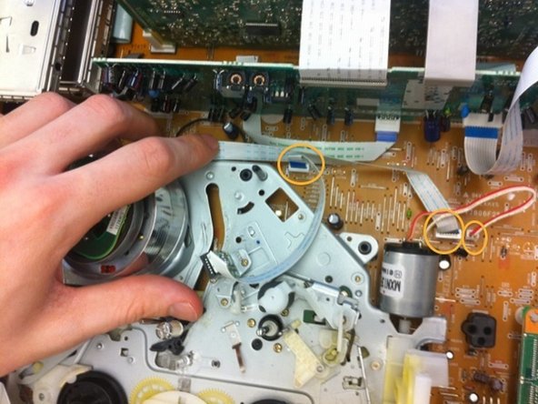

  7. Replacing Panasonic SA-HT810V New Screen, Motherboard, and Power Supply: crwdns2935265:07crwdnd2935265:01crwdnd2935265:02crwdne2935265:0 Replacing Panasonic SA-HT810V New Screen, Motherboard, and Power Supply: crwdns2935265:07crwdnd2935265:02crwdnd2935265:02crwdne2935265:0
    • Locate and remove the six screws that are circled in image one.
    • Remove the two electronic strips that are circled in image two that connect the VCR to the motherboard and unplug the cable.
    • Slowly remove the VCR by lifting it up and set aside. It may be difficult to slide the VCR from the black pegs that keep it in place.

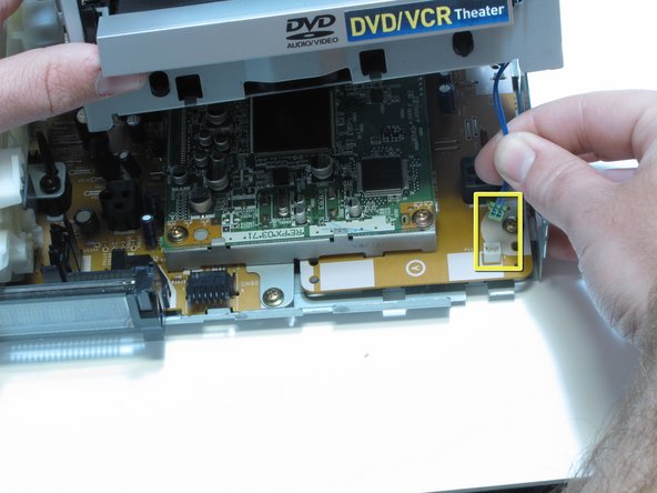

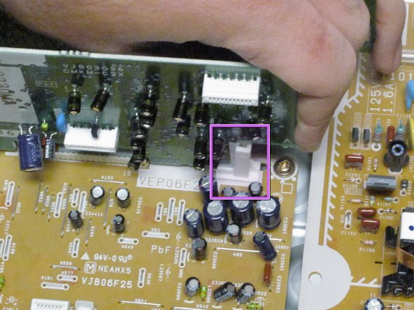

    • Remove electronic strips on the right, bottom center, top center, and a cable on the left side of the input board.
    • Remove two screws shown in the second image. Remove the gray connector on top of the input board.
    • Next, use a flat head screwdriver to assist you in prying the right clip while simultaneously pulling up on the input board. Unclip the component from the logic board.
    • Note that there is a clip on both the left and right sides of the input board.

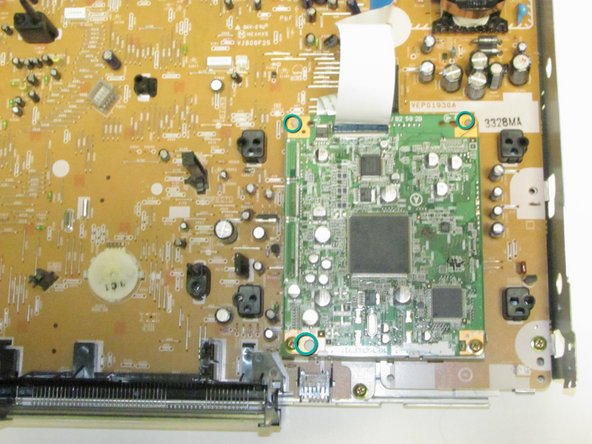

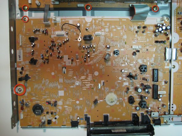

  9. Replacing Panasonic SA-HT810V New Screen, Motherboard, and Power Supply: crwdns2935265:09crwdnd2935265:01crwdnd2935265:02crwdne2935265:0 Replacing Panasonic SA-HT810V New Screen, Motherboard, and Power Supply: crwdns2935265:09crwdnd2935265:02crwdnd2935265:02crwdne2935265:0
    • In order to remove the DVD video processor, first locate and remove the two screws circled in image one.
    • The final step is popping of the component off of the three nodes circled in image three.
    • Unfortunately one or more of these 'nodes' will probably be difficult to remove and you will just have to pull on it until they come unattached or rotate the component to unhinge from the plastic clip.

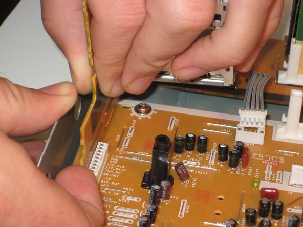

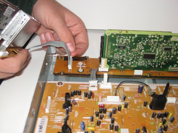

    • The next step is to remove the FM/AM radio receiver pictured in image one.
    • First unsnap it from the tab that holds it to the mother board (see image two).
    • Second, disconnect the electrical strip as seen in image three by pulling the tabs on the plastic piece of the electric strip.
    • Remove the black cable from the side slot.

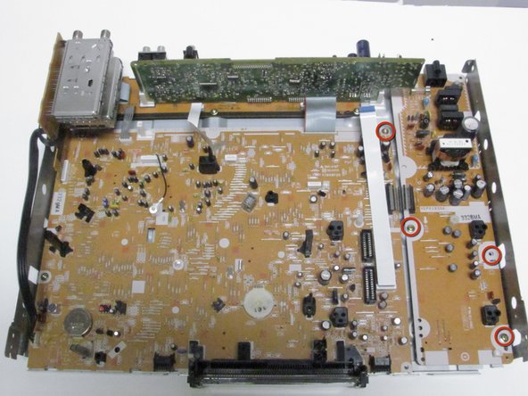

    • Before replacing the motherboard, it is crucial to understand that this device cannot be taken apart any further without breaking solder points. So the motherboard, screen and power supply must be replaced together.
    • Using a phillips head screwdriver, remove the thirteen screws that shown in images 1-3.
    • Lift up all of the components together making sure not to break any solder points.
    • To reassemble, follow these steps in reverse order.
