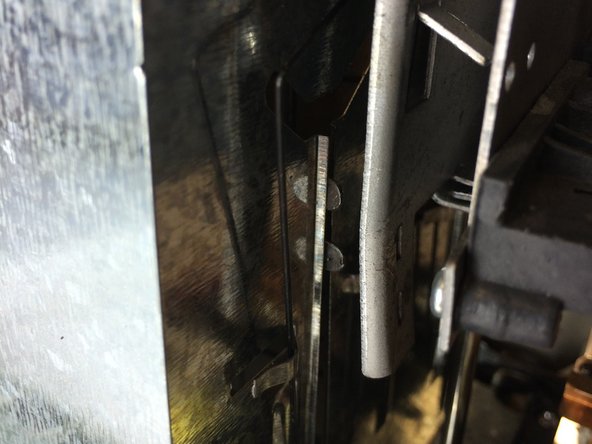

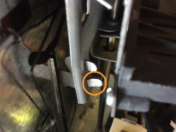

  6. Replacing Oster 6329 Bread Lift Shelf, Bread Lift Shelf: crwdns2935265:06crwdnd2935265:01crwdnd2935265:01crwdne2935265:0
    • Use a flat-head screwdriver to separate the metal flap from the metal plate.
  7. Replacing Oster 6329 Bread Lift Shelf: crwdns2935265:07crwdnd2935265:01crwdnd2935265:02crwdne2935265:0 Replacing Oster 6329 Bread Lift Shelf: crwdns2935265:07crwdnd2935265:02crwdnd2935265:02crwdne2935265:0
    • Grasp the metal flap with the large needle nose pliers.
    • Unbend metal flap until at a 90 degree angle from the metal plate.
    • Repeat these steps for the second metal flap.
  8. Replacing Oster 6329 Bread Lift Shelf: crwdns2935265:08crwdnd2935265:01crwdnd2935265:01crwdne2935265:0
    • Use the large need nose pliers to grab the metal panel.
    • Pull the metal panel away from the body of the toaster to dislodge the flaps.
  9. Replacing Oster 6329 Bread Lift Shelf: crwdns2935265:09crwdnd2935265:01crwdnd2935265:02crwdne2935265:0 Replacing Oster 6329 Bread Lift Shelf: crwdns2935265:09crwdnd2935265:02crwdnd2935265:02crwdne2935265:0
    • Push the metal flaps towards the body of the toaster to access the bread lift shelf.
  10. Replacing Oster 6329 Bread Lift Shelf: crwdns2935265:010crwdnd2935265:01crwdnd2935265:01crwdne2935265:0
    • Push down on the opposite side of the bread lift shelf to expose the metal flaps.
  11. Replacing Oster 6329 Bread Lift Shelf: crwdns2935265:011crwdnd2935265:01crwdnd2935265:01crwdne2935265:0
    • Pull up on the bread lift shelf to remove from the toaster.
