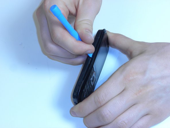

    • Press down on the button located at the bottom of the phone, using the center ridge as a guide.
    • Pull the phone apart from the bottom, keeping the button pressed down.
    • CAUTION! The plastic opening tool may be used to gain leverage. Some force is required to open.
  2. Replacing Nokia Classic 2600c-2b Faceplate: crwdns2935265:02crwdnd2935265:01crwdnd2935265:01crwdne2935265:0
    • Remove the back cover to expose the battery.
  3. Replacing Nokia Classic 2600c-2b Faceplate: crwdns2935265:03crwdnd2935265:01crwdnd2935265:02crwdne2935265:0 Replacing Nokia Classic 2600c-2b Faceplate: crwdns2935265:03crwdnd2935265:02crwdnd2935265:02crwdne2935265:0
    • Place a finger or plastic opening tool in the gap between the battery and the phone.
    • Gently lift the battery out.
  4. Replacing Nokia Classic 2600c-2b Faceplate: crwdns2935265:04crwdnd2935265:01crwdnd2935265:02crwdne2935265:0 Replacing Nokia Classic 2600c-2b Faceplate: crwdns2935265:04crwdnd2935265:02crwdnd2935265:02crwdne2935265:0
    • Locate the plastic latches on the left and right sides of the phone.
    • Insert the plastic opening tool or a fingernail into each latch and pry them open individually.
    • CAUTION! Some force is required.
  5. Replacing Nokia Classic 2600c-2b Faceplate: crwdns2935265:05crwdnd2935265:01crwdnd2935265:01crwdne2935265:0
    • Remove the faceplate with the number pad attached.
  6. Replacing Nokia Classic 2600c-2b Faceplate: crwdns2935265:06crwdnd2935265:01crwdnd2935265:01crwdne2935265:0
    • Turn the faceplate so the number pad faces downward.
    • Lift the number pad out of the faceplate.
    • Apply new faceplate.
    • Follow the instructions in reverse order to reassemble the phone.
