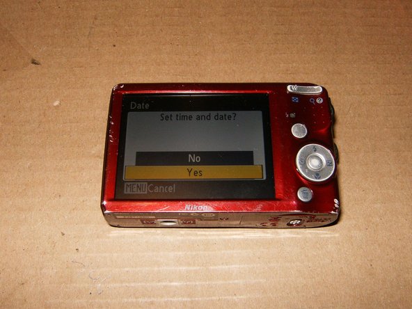

    • Okay, so here is Nikon Coolpix L20 purchased for $8.00. Only issue identified is an obviously cracked LCD screen

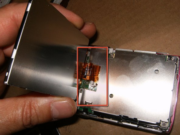

    • With the halves separated, you are now looking at the LCD in the bracket unit.
    • gently fold the LCD toward the ribbon cable out of the bracket unit. DO NOT try to remove the LCD or to loosen the cable.
    • Remove the four screws from the bracket unit.
  5. Replacing Nikon Coolpix L20 LCD: crwdns2935265:05crwdnd2935265:01crwdnd2935265:03crwdne2935265:0 Replacing Nikon Coolpix L20 LCD: crwdns2935265:05crwdnd2935265:02crwdnd2935265:03crwdne2935265:0 Replacing Nikon Coolpix L20 LCD: crwdns2935265:05crwdnd2935265:03crwdnd2935265:03crwdne2935265:0
    • When you remove this screw, make sure that the shield plate on top of the bracket plate, is just slightly pushed out of the way. This will free the bracket plate.
    • After the removal of the bracket plate, you have access to the connector. Move the white clip gently to the lift (upright) position, to free the cable.
    • The LCD should now easily separate from the logic board.
  6. Replacing Nikon Coolpix L20 LCD: crwdns2935265:06crwdnd2935265:01crwdnd2935265:03crwdne2935265:0 Replacing Nikon Coolpix L20 LCD: crwdns2935265:06crwdnd2935265:02crwdnd2935265:03crwdne2935265:0 Replacing Nikon Coolpix L20 LCD: crwdns2935265:06crwdnd2935265:03crwdnd2935265:03crwdne2935265:0
    • For the reassembly, the trickiest part is to bend the LCD ribbon cable so that it fold under the LCD into the bracket unit.
    • Use caution and patience so as to not cut the cable on the bracket unit.
    • After reassembly, you should hopefully have the same result as I did. Total cost $8.00 for the camera, $15.00 for the LCD and one hour of my time...
