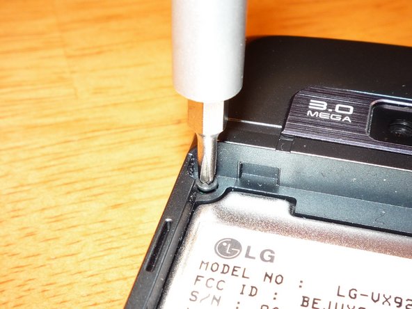

  3. Replacing LG enV3 (VX9200) Screen/LCD: crwdns2935265:03crwdnd2935265:01crwdnd2935265:02crwdne2935265:0 Replacing LG enV3 (VX9200) Screen/LCD: crwdns2935265:03crwdnd2935265:02crwdnd2935265:02crwdne2935265:0
    • Remove 5 small black screws from the back cover. I used a #00 Philips screwdriver, but a #0 should also work as well.

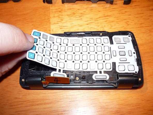

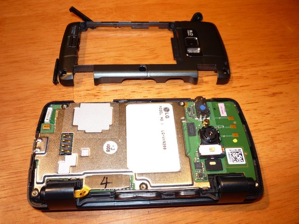

  5. Replacing LG enV3 (VX9200) Screen/LCD: crwdns2935265:05crwdnd2935265:01crwdnd2935265:02crwdne2935265:0 Replacing LG enV3 (VX9200) Screen/LCD: crwdns2935265:05crwdnd2935265:02crwdnd2935265:02crwdne2935265:0
    • Disconnect the front flip cable from the logic board. It just snaps up and off.
    • Remove the logic PCB, simply by lifting any corner and working it out around the one cable.
    • Remove the flexible keyboard from the frame.

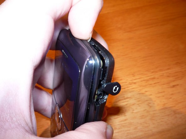

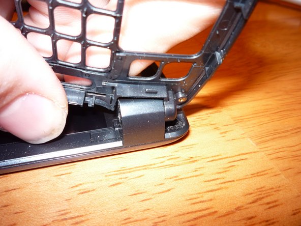

    • The case comes off the front display by bending the frame around clips in the hinges. On the side with the cable, bend the outer edge toward the screen to get it around a post.
    • The side with the cable has an insert that tends to slide backwards when the opposite side isn't holding it in place. Push it back in during reassembly if you're finding that you can't get the case to fit back on.
    • To get the mechanism side off, it takes a little more bending force. Bend the left edge (hence the rest of the frame) outwards toward the screen to get it off, and it'll release around the metal hinge mechanism.

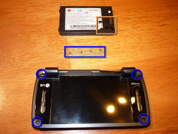

  7. Replacing LG enV3 (VX9200) Screen/LCD: crwdns2935265:07crwdnd2935265:01crwdnd2935265:02crwdne2935265:0 Replacing LG enV3 (VX9200) Screen/LCD: crwdns2935265:07crwdnd2935265:02crwdnd2935265:02crwdne2935265:0
    • Remove four screw covers from around the screen. Stick them to something clean, so they can be re-stuck later.
    • Remove four small silver screws. They are all of the same size.

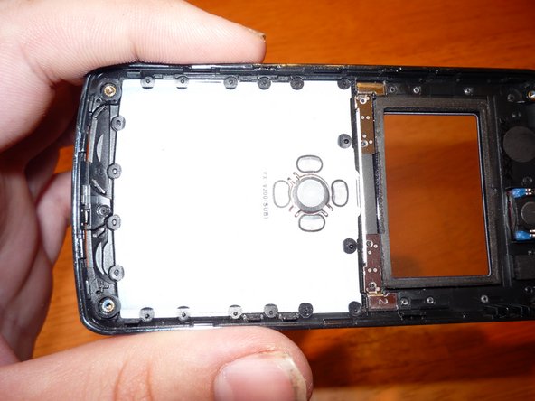

  8. Replacing LG enV3 (VX9200) Screen/LCD: crwdns2935265:08crwdnd2935265:01crwdnd2935265:02crwdne2935265:0 Replacing LG enV3 (VX9200) Screen/LCD: crwdns2935265:08crwdnd2935265:02crwdnd2935265:02crwdne2935265:0
    • The cover can be snapped apart in a similar fashion to the bottom case.
    • Next to the new screen, you can see what's still left to be removed. This involves a little bit of soldering, but not too much.
    • When reassembling, ensure that the button pad is fully seated in each of the pegs. This can prevent the cover from snapping together properly. It's a pretty tight fit!

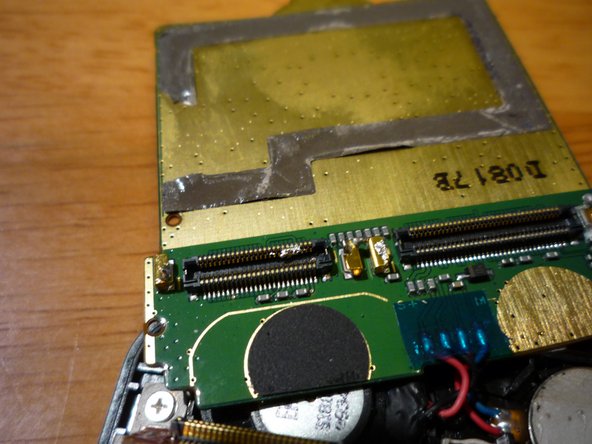

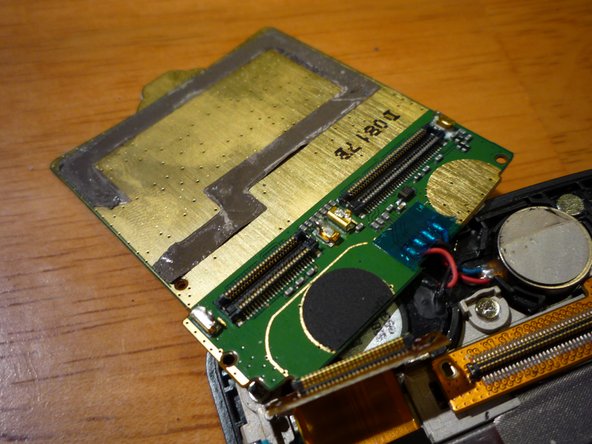

  9. Replacing LG enV3 (VX9200) Screen/LCD: crwdns2935265:09crwdnd2935265:01crwdnd2935265:03crwdne2935265:0 Replacing LG enV3 (VX9200) Screen/LCD: crwdns2935265:09crwdnd2935265:02crwdnd2935265:03crwdne2935265:0 Replacing LG enV3 (VX9200) Screen/LCD: crwdns2935265:09crwdnd2935265:03crwdnd2935265:03crwdne2935265:0
    • Here comes the fun part. You see that? LG decided to solder down the snap connectors to the display and keypad. It's your job to disconnect them... somehow.
    • To disconnect them, I applied upward pressure to the edge of the connector (which also held the board up with one hand), and applied the tip of the soldering iron to the edge I was pulling up on. When it melted, it popped off, leaving the other side. Repeat for each side until both cables are disconnected.
    • These connections are very fragile. The cable from the hinge is a multi-layer cable with many thin layers. It's not recommended to desolder only the display connector, as it won't allow enough room to move and would stress the hinge cable quite a bit.
    • When I disconnected the LCD cable, it splashed a little solder onto the contacts. Fortunately, it requires heat to prep the metal to adhere to solder, so it simply flaked off with the edge of the razor blade. DO NOT use the soldering iron to try to clean any accidental blobs, it will only result in disaster.
    • When reassembling, be sure not to keep the heat on it too long. Plastic likes to melt.
    • After the LCD display has been removed, you'll have to desolder the connection holding the little speaker(?) in the upper corner. The way this is assembled is there are two layers sandwiched together. So just heat the two connections while pulling them slightly and they'll come right apart when the solder melts. You'll have to re-attach it to the new LCD.

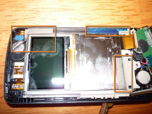

  10. Replacing LG enV3 (VX9200) Screen/LCD: crwdns2935265:010crwdnd2935265:01crwdnd2935265:02crwdne2935265:0 Replacing LG enV3 (VX9200) Screen/LCD: crwdns2935265:010crwdnd2935265:02crwdnd2935265:02crwdne2935265:0
    • Remove 2 small silver screws from the LCD support frame. They are the same size.
    • Remove 3 strips of tape - 2 silver and 1 blue.
    • When reassembling, I left the tape stuck to my coffee table. It's up to you. I wouldn't recommend re-using it, it's likely lost all its "stick".
