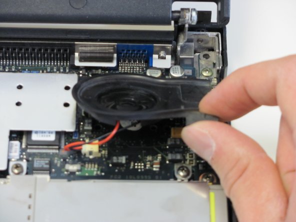

  10. Replacing IBM ThinkPad 560z Speaker, Speaker: crwdns2935265:010crwdnd2935265:01crwdnd2935265:02crwdne2935265:0 Replacing IBM ThinkPad 560z Speaker, Speaker: crwdns2935265:010crwdnd2935265:02crwdnd2935265:02crwdne2935265:0
    • Slowly and carefully lift the speaker with your fingers.
    • The port that the speaker plugs into can be easily removed from the motherboard if not careful! Unplug the speaker with extreme caution!

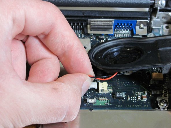

  11. Replacing IBM ThinkPad 560z Speaker: crwdns2935265:011crwdnd2935265:01crwdnd2935265:02crwdne2935265:0 Replacing IBM ThinkPad 560z Speaker: crwdns2935265:011crwdnd2935265:02crwdnd2935265:02crwdne2935265:0
    • Use your fingers to unplug the wires from the connector.
