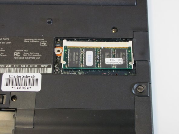

  1. Replacing IBM ThinkPad 560z RAM, Battery Removal: crwdns2935265:01crwdnd2935265:01crwdnd2935265:01crwdne2935265:0
    • Slide the battery release latch to the right.
    • Pull out the battery out towards the front of the device.
  2. Replacing IBM ThinkPad 560z RAM, RAM: crwdns2935265:02crwdnd2935265:01crwdnd2935265:01crwdne2935265:0
    • Remove a single phillips head screw.
  3. Replacing IBM ThinkPad 560z RAM: crwdns2935265:03crwdnd2935265:01crwdnd2935265:02crwdne2935265:0 Replacing IBM ThinkPad 560z RAM: crwdns2935265:03crwdnd2935265:02crwdnd2935265:02crwdne2935265:0
    • Lift the cover to reveal the RAM.
  4. Replacing IBM ThinkPad 560z RAM: crwdns2935265:04crwdnd2935265:01crwdnd2935265:02crwdne2935265:0 Replacing IBM ThinkPad 560z RAM: crwdns2935265:04crwdnd2935265:02crwdnd2935265:02crwdne2935265:0
    • Use your fingers to push apart the clamps holding the RAM.
  5. Replacing IBM ThinkPad 560z RAM: crwdns2935265:05crwdnd2935265:01crwdnd2935265:01crwdne2935265:0
    • Use your fingers to pull out the RAM.
