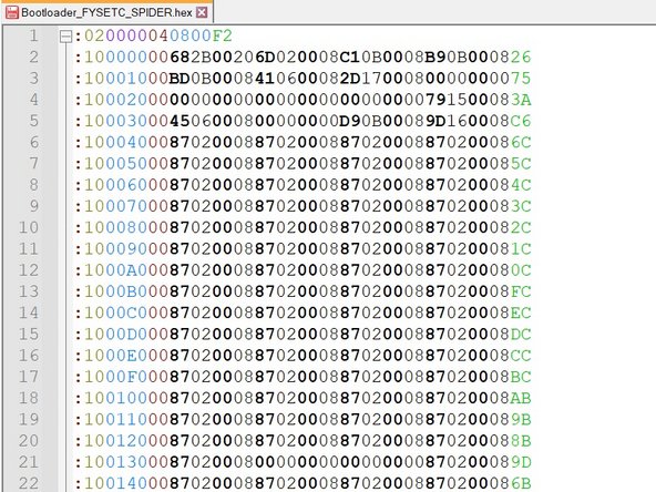

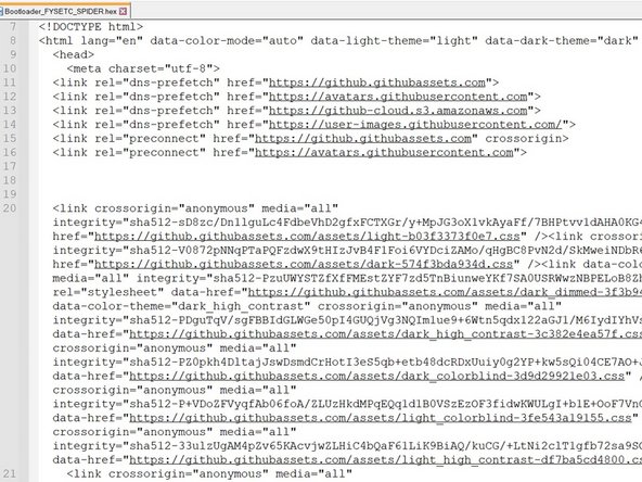

    • Go to the FYSETC github. You need to download the bootloader. Right click on the file and select "save link as..." and save the .hex file
    • Open the .hex file in Notepad++ and you see it downloads the html data instead of the .hex file.
    • On the Github page click on Bootloader_FYSETC_SPIDER.hex
    • Select "Raw". Copy the data in the web browser and paste it into the .hex file in Notepad++ and save it.

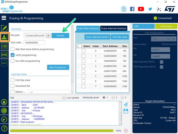

    • Select the refresh button
    • When the USB port shows next to the Port drop down select connect.
    • Make sure you're on the Erasing & Programming tab
    • Select Browse and select the "Bootloader_FYSETC_SPIDER.hex" file from earlier.
    • Click Start Programming.
    • It should only take a few seconds to program the board.
    • Disconnect the power and USB-C cable. Remove the jumper on BT0 and 3.3v

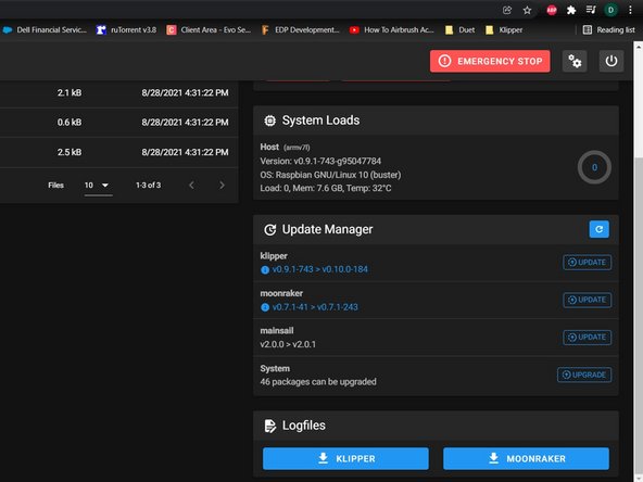

    • Navigate to the Machine tab on the left.
    • Select Upgrade to update the RPI image and Update to install updates for Klipper, Mainsail and Moonraker. Once the updates are complete reboot the RPI

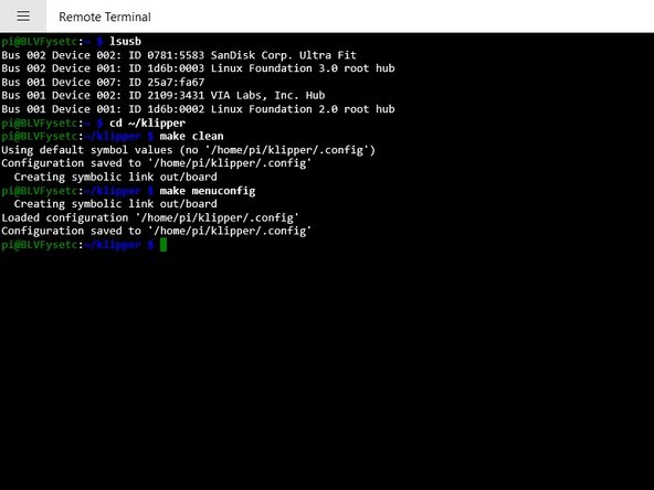

    • After updating mainsail and all core components, SSH into the RPI.

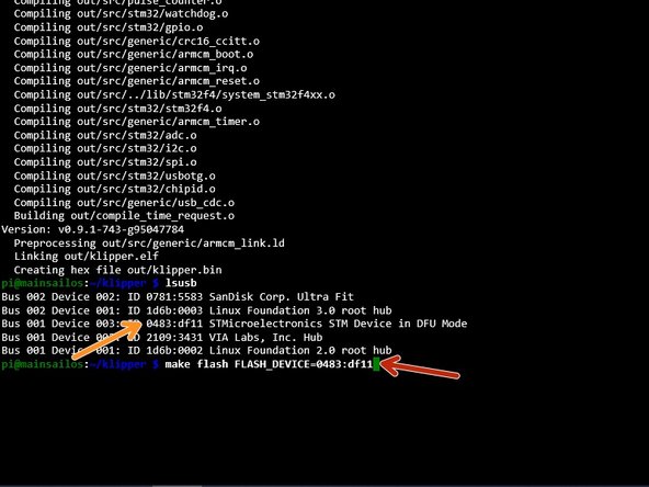

    • Place a jumper on BT0 and 3.3v and press the reset button on the board to put it in DFUtil mode
    • Send the following to verify the Pi can communicate with the Spider and notate the ID for DFU Mode
    • lsusb
    • Next you need to build the firmware binary file. Run the following
    • cd ~/klipper
    • make clean
    • make menuconfig

    • make

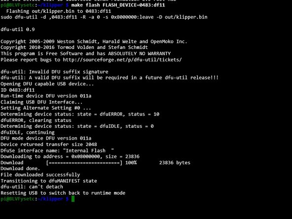

    • make flash FLASH_DEVICE=####:####
    • Using the ID you notated earlier in place of ####:####
    • Power off the Spider. Remove the jumper and press the reset button on the board.
    • Run the following
    • ls /dev/serial/by-id/* or lsusb
    • This is the ID you will put in printer.cfg

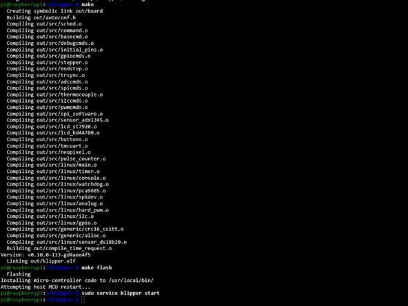

    • Run the following:
    • sudo service klipper stop
    • make
    • make flash
    • sudo service klipper start

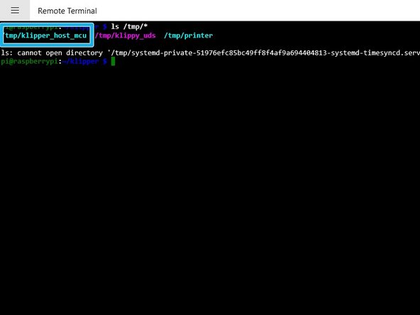

    • Verify klipper_host_mcu is in the tmp directory with ls /tmp/*
    • Add the pi to the TTY group
    • sudo usermod -a -G tty pi

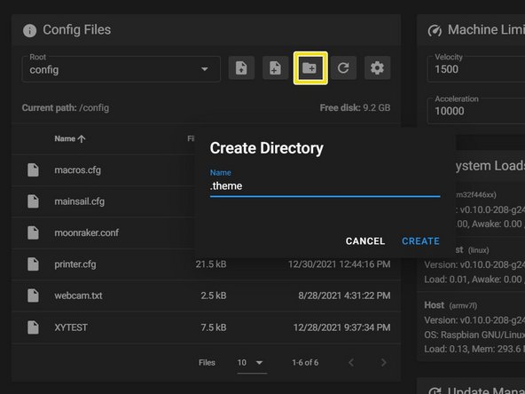

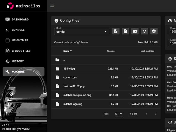

    • Download the file and extract.
    • Under "machine" menu, click on the Gear icon and select the checkbox for "show hidden files".
    • Select "Create Directory".
    • In the name field enter “.theme” and select CREATE.
    • it has to be named as seen in the screenshot.
    • Select the newly created ".theme" folder. Upload all the files from the zip archive into .theme folder.
    • hit Ctrl+F5 and Enjoy.
