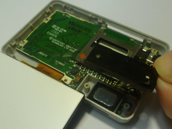

  5. Replacing Creative Zen X-Fi Speaker, Access Midsection Plate: crwdns2935265:05crwdnd2935265:01crwdnd2935265:01crwdne2935265:0
    • Lift open the LCD screen and button input chip to access the entire midsection plate.
  6. Replacing Creative Zen X-Fi Speaker, Unscrew below Button Chip: crwdns2935265:06crwdnd2935265:01crwdnd2935265:01crwdne2935265:0
    • Use a Phillips Head screwdriver to unscrew the three 3/16 inch screws that were underneath the button input chip.
  7. Replacing Creative Zen X-Fi Speaker, Unscrew below LCD Screen: crwdns2935265:07crwdnd2935265:01crwdnd2935265:01crwdne2935265:0
    • Use a Phillips Head screwdriver to unscrew the three 3/16 inch screws that were underneath the LCD screen.
  8. Replacing Creative Zen X-Fi Speaker, Unscrew Speaker's Cover: crwdns2935265:08crwdnd2935265:01crwdnd2935265:02crwdne2935265:0 Replacing Creative Zen X-Fi Speaker, Unscrew Speaker's Cover: crwdns2935265:08crwdnd2935265:02crwdnd2935265:02crwdne2935265:0
    • Use a Phillips Head screwdriver to unscrew the 3/16 inch screw that attaches the speaker's cover the the back case.
    • Once unscrewed, pick up the case and put it to the side.
  9. Replacing Creative Zen X-Fi Speaker, Removing the Speaker: crwdns2935265:09crwdnd2935265:01crwdnd2935265:01crwdne2935265:0
    • With the speaker exposed, use a pair of tweezers to lift the speaker out of the slot.
