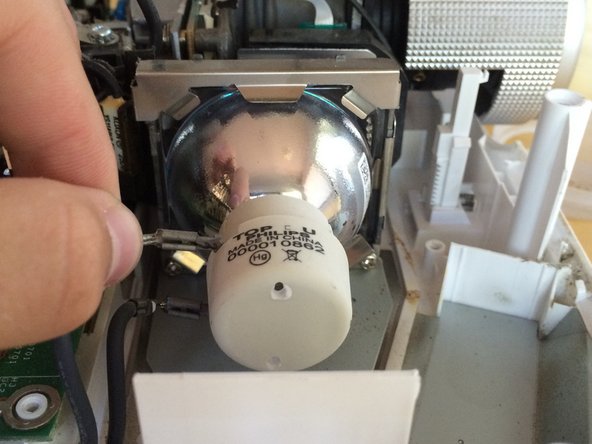

  11. Replacing BenQ MP512ST Projector Central Fan: crwdns2935265:011crwdnd2935265:01crwdnd2935265:02crwdne2935265:0 Replacing BenQ MP512ST Projector Central Fan: crwdns2935265:011crwdnd2935265:02crwdnd2935265:02crwdne2935265:0
    • Disconnect the power supply from the light bulb by gently pulling on the two metal tabs attached to it.
