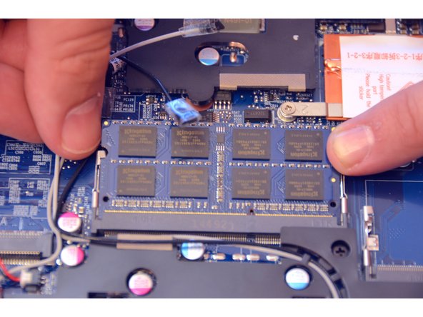

    1. Replacement or expansion RAM, RAM: crwdns2935265:04crwdnd2935265:01crwdnd2935265:03crwdne2935265:0 Replacement or expansion RAM, RAM: crwdns2935265:04crwdnd2935265:02crwdnd2935265:03crwdne2935265:0 Replacement or expansion RAM, RAM: crwdns2935265:04crwdnd2935265:03crwdnd2935265:03crwdne2935265:0
      • Here is the RAM bar installed by default.
      • Locate and remove the spring blades that hold the memory module in place.
      • Remove the memory module (RAM).

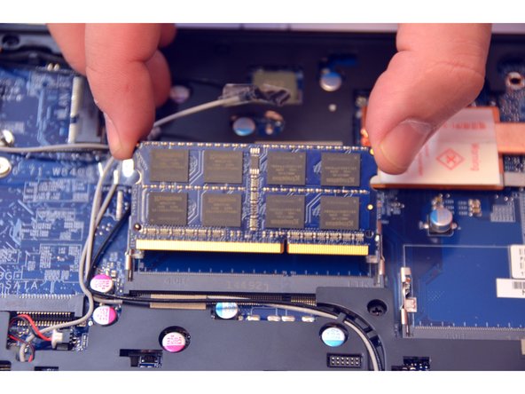

    2. Replacement or expansion RAM: crwdns2935265:05crwdnd2935265:01crwdnd2935265:01crwdne2935265:0
      • Here is the RAM bar out of its location.
To reassemble your device follow the instructions in reverse order
