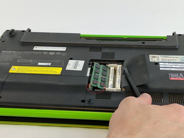

    • Turn the laptop upside down. Locate a removable cover, that is screwed shut near the front right of the laptop which is upside down.
  2. Replacement Ram: crwdns2935265:02crwdnd2935265:01crwdnd2935265:01crwdne2935265:0
    • After removing the screw, using your finger slowly lift out and remove the cover.
  3. Replacement Ram: crwdns2935265:03crwdnd2935265:01crwdnd2935265:03crwdne2935265:0 Replacement Ram: crwdns2935265:03crwdnd2935265:02crwdnd2935265:03crwdne2935265:0 Replacement Ram: crwdns2935265:03crwdnd2935265:03crwdnd2935265:03crwdne2935265:0
    • Lift the flap
    • Locate two connectors on both ends of the short end. This will release the ram, if properly done the long end should slightly lift.
    • The ram is to be removed at a 45 degree angle.
  4. Replacement Ram: crwdns2935265:04crwdnd2935265:01crwdnd2935265:01crwdne2935265:0
    • Pull out cleanly and you have now successfully removed the ram.
