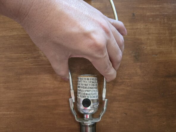

  2. Replace the Light Socket in a Desk Lamp: crwdns2935265:02crwdnd2935265:01crwdnd2935265:03crwdne2935265:0 Replace the Light Socket in a Desk Lamp: crwdns2935265:02crwdnd2935265:02crwdnd2935265:03crwdne2935265:0 Replace the Light Socket in a Desk Lamp: crwdns2935265:02crwdnd2935265:03crwdnd2935265:03crwdne2935265:0
    • Grip the harp saddle firmly and lift it straight up to release it from the socket base.
    • Some lamps have clips or tension that hold the saddle in place—if yours does, gently squeeze the sides to loosen it.
    • Set the saddle aside for reassembly later.

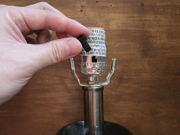

  3. Replace the Light Socket in a Desk Lamp: crwdns2935265:03crwdnd2935265:01crwdnd2935265:02crwdne2935265:0 Replace the Light Socket in a Desk Lamp: crwdns2935265:03crwdnd2935265:02crwdnd2935265:02crwdne2935265:0
    • Turn the light switch handle counterclockwise to remove it.
    • Some handles may be snug, so take your time and avoid forcing it.

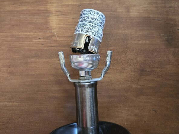

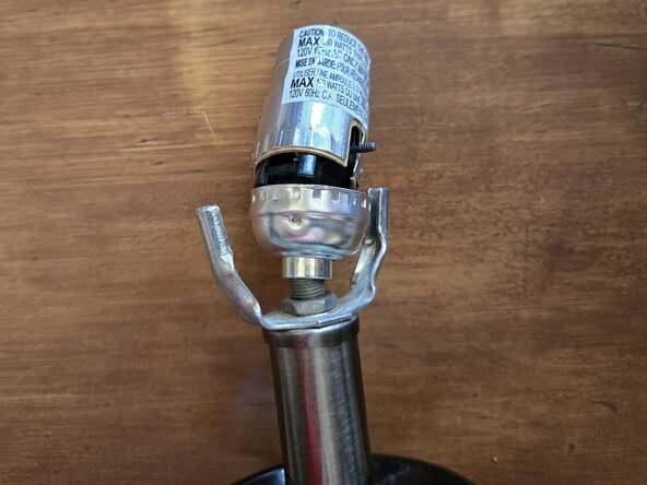

  4. Replace the Light Socket in a Desk Lamp: crwdns2935265:04crwdnd2935265:01crwdnd2935265:03crwdne2935265:0 Replace the Light Socket in a Desk Lamp: crwdns2935265:04crwdnd2935265:02crwdnd2935265:03crwdne2935265:0 Replace the Light Socket in a Desk Lamp: crwdns2935265:04crwdnd2935265:03crwdnd2935265:03crwdne2935265:0
    • Gently pull the socket shell up from the lamp base.
    • Some sockets may be snug or clipped in. If so, gently wiggle the socket while pulling to loosen it.
    • Be careful not to pull too hard on the wires—they are still connected underneath.

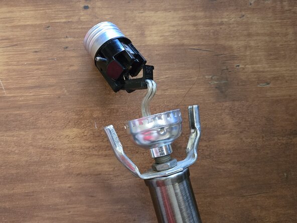

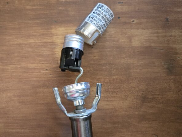

  5. Replace the Light Socket in a Desk Lamp: crwdns2935265:05crwdnd2935265:01crwdnd2935265:03crwdne2935265:0 Replace the Light Socket in a Desk Lamp: crwdns2935265:05crwdnd2935265:02crwdnd2935265:03crwdne2935265:0 Replace the Light Socket in a Desk Lamp: crwdns2935265:05crwdnd2935265:03crwdnd2935265:03crwdne2935265:0
    • Carefully open the inner socket housing to access the wire connections.
    • Depending on your lamp model, you may need to unscrew the socket, release a locking tab, or separate a snap-fit joint.
    • Use a screwdriver to loosen the terminal screws or clips and gently disconnect the wires.
  6. Replace the Light Socket in a Desk Lamp: crwdns2935265:06crwdnd2935265:01crwdnd2935265:02crwdne2935265:0 Replace the Light Socket in a Desk Lamp: crwdns2935265:06crwdnd2935265:02crwdnd2935265:02crwdne2935265:0
    • Release the wire by loosening screws, releasing clips, or pulling them from push-in connectors, depending on the socket.
    • Take note of how the wires were connected for reassembly later.
