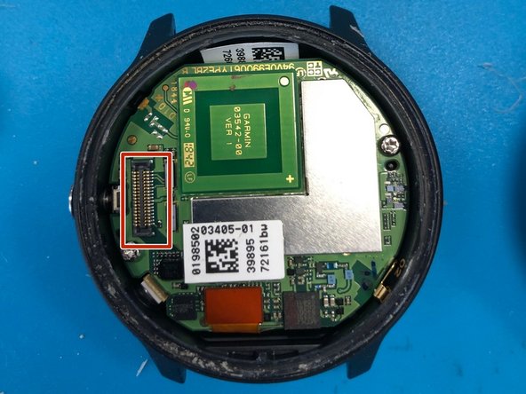

  3. Replace of the Hearth Rate Sensor, Disconnecting the screen from the main board: crwdns2935265:03crwdnd2935265:01crwdnd2935265:02crwdne2935265:0 Replace of the Hearth Rate Sensor, Disconnecting the screen from the main board: crwdns2935265:03crwdnd2935265:02crwdnd2935265:02crwdne2935265:0
    • Once opened, remove carefully the screen's ribbon cable. It is recommended to use plastic tools during the whole process. You should consider that the battery is still connected.
  4. Replace of the Hearth Rate Sensor, Screen and case: crwdns2935265:04crwdnd2935265:01crwdnd2935265:02crwdne2935265:0 Replace of the Hearth Rate Sensor, Screen and case: crwdns2935265:04crwdnd2935265:02crwdnd2935265:02crwdne2935265:0
    • Thus, the bottom part of the board with all the sensors is exposed.
    • In the second picture, you will be able to observe the screen, with the connector being highlighted.

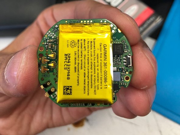

  5. Replace of the Hearth Rate Sensor, Removing the clock's brain: crwdns2935265:05crwdnd2935265:01crwdnd2935265:01crwdne2935265:0
    • Remove the screws using a torx screwdriver.
    • Disconnect the clock's sensors connection bus using a spudger.
    • The small golden piece exerts pressure in between the case and the clock's processor.
  6. Replace of the Hearth Rate Sensor, Removing the processor.: crwdns2935265:06crwdnd2935265:01crwdnd2935265:02crwdne2935265:0 Replace of the Hearth Rate Sensor, Removing the processor.: crwdns2935265:06crwdnd2935265:02crwdnd2935265:02crwdne2935265:0
    • Here you can replace the battery if needed. It is soldered through two cables to the clock's motherboard.
