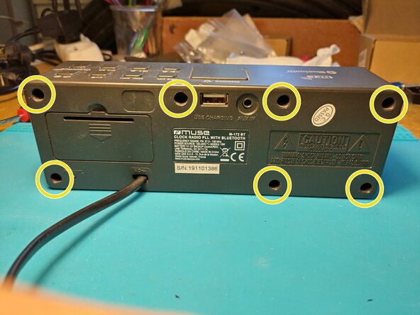

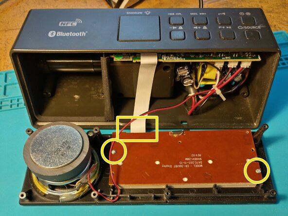

    • Unplug the power supply from the wall, remove batteries.

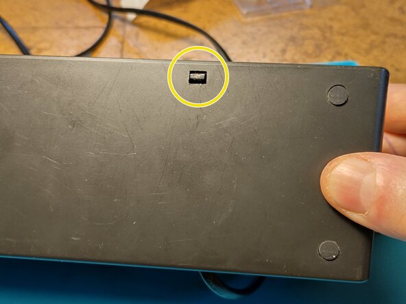

    • Unscrew x7 and open the device by unlocking the plastic clip on the bottom face.

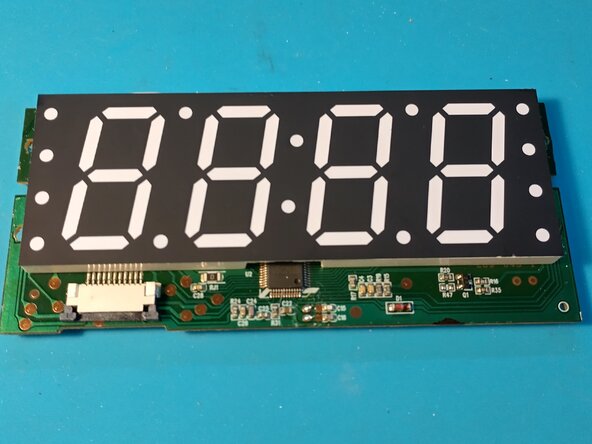

    • On the rear of the display panel, unscrew x2 and unclip the flat cable.

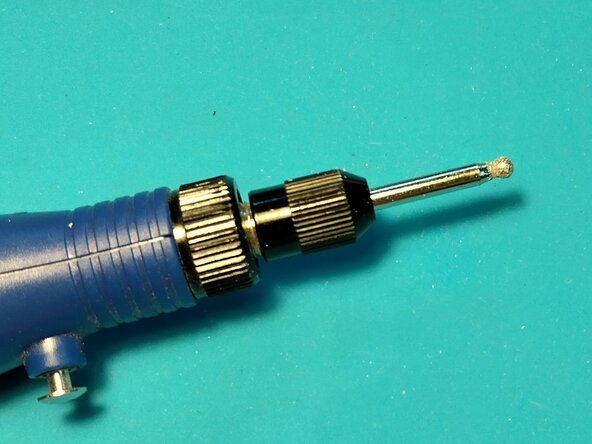

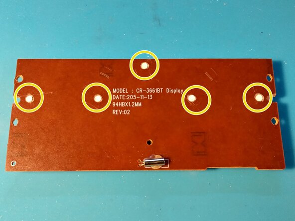

    • We want to separate the digit support from the PCB to access the leds.
    • On the back, mill the white clips to free the PCB from the digit support. I used a Dremel like tool.

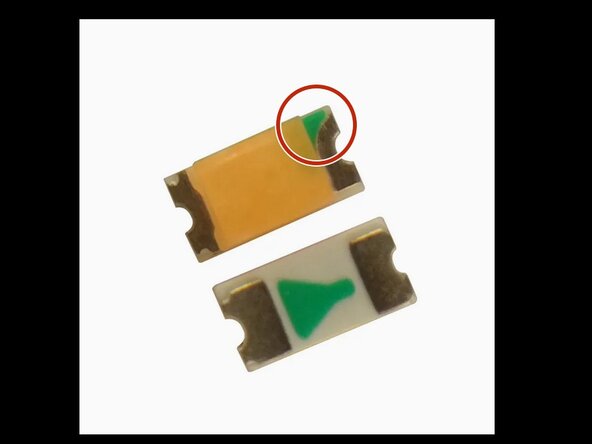

  3. Replace faultly digit: crwdns2935265:03crwdnd2935265:01crwdnd2935265:02crwdne2935265:0 Replace faultly digit: crwdns2935265:03crwdnd2935265:02crwdnd2935265:02crwdne2935265:0

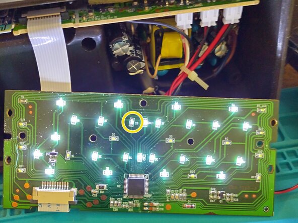

    • You can test the leds by plug in the flat cable. Be carefull of high voltage.
    • In my case, I had to replace the 2B led. Locate the green mark before unsoldering the led. Green mark goes to the driver chip.
    • To buy leds, search Internet with key words : white led smd 0603
    • Once done, you can try the led fix and reassemble the device.
