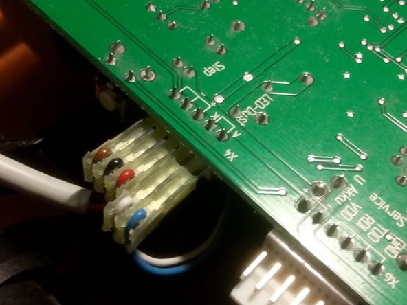

    • Unplug the on/off switch.
    • Unplug the connector for the charging contacts.

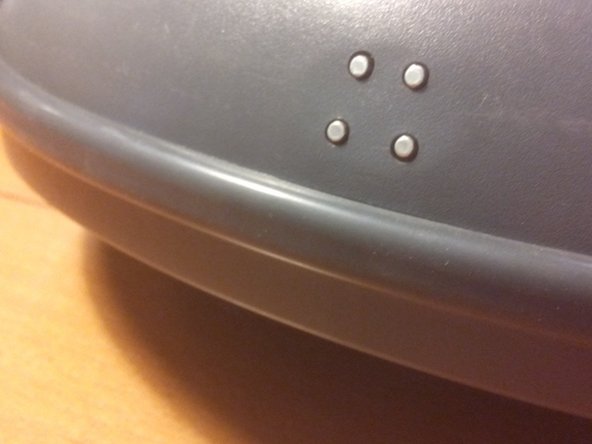

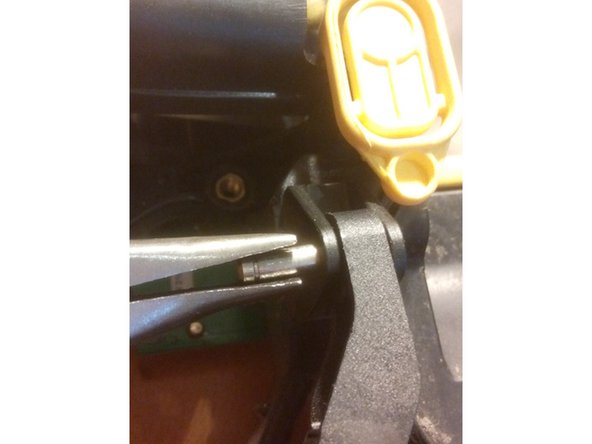

  4. Replace Kärcher RC3000 brush motor. replacement: crwdns2935265:04crwdnd2935265:01crwdnd2935265:03crwdne2935265:0 Replace Kärcher RC3000 brush motor. replacement: crwdns2935265:04crwdnd2935265:02crwdnd2935265:03crwdne2935265:0 Replace Kärcher RC3000 brush motor. replacement: crwdns2935265:04crwdnd2935265:03crwdnd2935265:03crwdne2935265:0

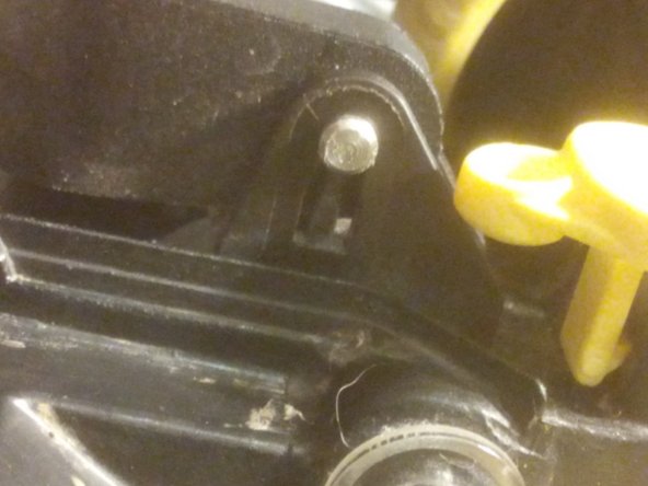

    • remove pins. Caution, risk of injury for the inexperienced.

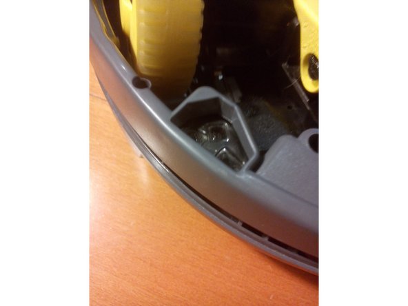

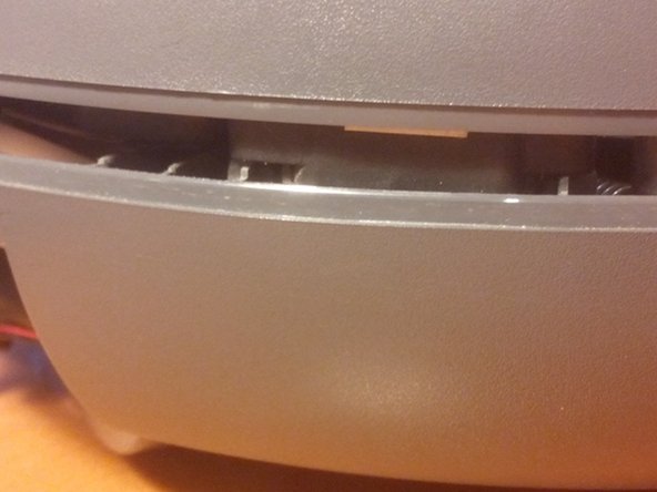

  5. Replace Kärcher RC3000 brush motor. replacement: crwdns2935265:05crwdnd2935265:01crwdnd2935265:01crwdne2935265:0

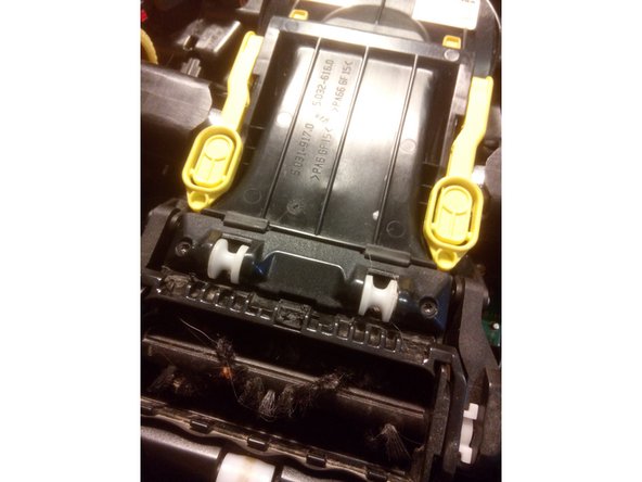

    • Detach outer upper case (do not remove yet!). To do this, loosen 4 screws. With slotted screwdriver or 8 Torx.
  6. Replace Kärcher RC3000 brush motor. replacement: crwdns2935265:06crwdnd2935265:01crwdnd2935265:01crwdne2935265:0

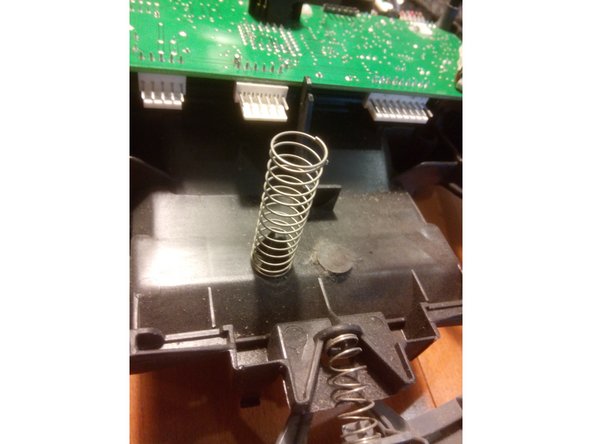

    • rotate device. Hold both frames. Be careful, the screws will fall out. 4 left?
    • Now carefully remove the upper cover without pressing the lower part down. Then the springs remain mounted!

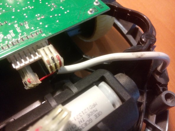

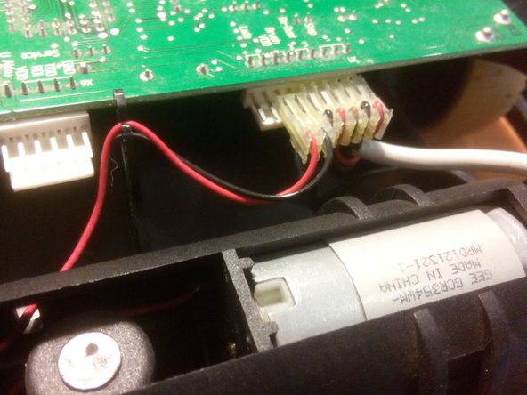

  7. Replace Kärcher RC3000 brush motor. replacement: crwdns2935265:07crwdnd2935265:01crwdnd2935265:02crwdne2935265:0 Replace Kärcher RC3000 brush motor. replacement: crwdns2935265:07crwdnd2935265:02crwdnd2935265:02crwdne2935265:0

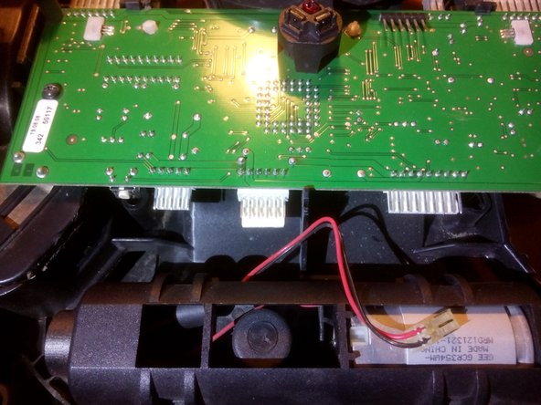

    • Disconnect the brush motor connector.
    • ..and the others on the site too.

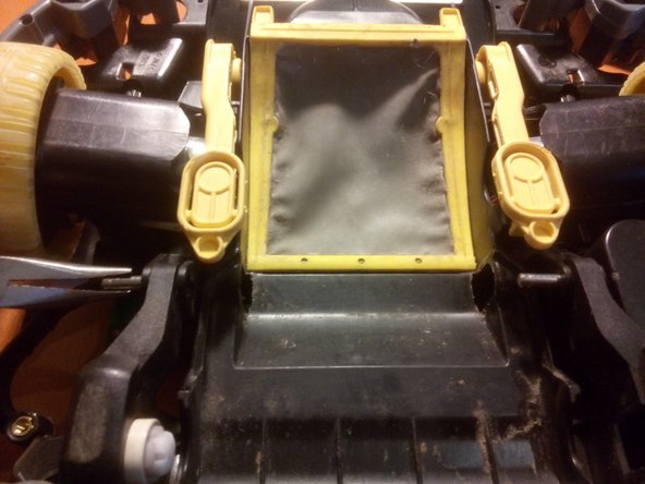

  8. Replace Kärcher RC3000 brush motor. replacement: crwdns2935265:08crwdnd2935265:01crwdnd2935265:02crwdne2935265:0 Replace Kärcher RC3000 brush motor. replacement: crwdns2935265:08crwdnd2935265:02crwdnd2935265:02crwdne2935265:0
    • Remove brush motor.
    • Congratulations, mountain party

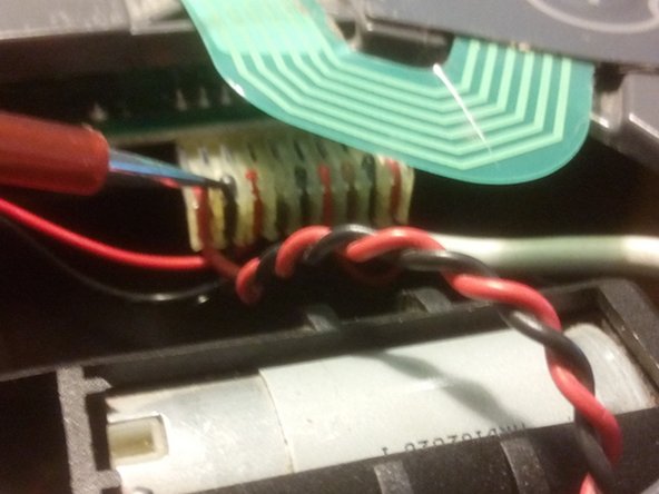

  10. Replace Kärcher RC3000 brush motor. replacement: crwdns2935265:010crwdnd2935265:01crwdnd2935265:03crwdne2935265:0 Replace Kärcher RC3000 brush motor. replacement: crwdns2935265:010crwdnd2935265:02crwdnd2935265:03crwdne2935265:0 Replace Kärcher RC3000 brush motor. replacement: crwdns2935265:010crwdnd2935265:03crwdnd2935265:03crwdne2935265:0
    • plug in.
  11. Replace Kärcher RC3000 brush motor. replacement: crwdns2935265:011crwdnd2935265:01crwdnd2935265:03crwdne2935265:0 Replace Kärcher RC3000 brush motor. replacement: crwdns2935265:011crwdnd2935265:02crwdnd2935265:03crwdne2935265:0 Replace Kärcher RC3000 brush motor. replacement: crwdns2935265:011crwdnd2935265:03crwdnd2935265:03crwdne2935265:0
    • ...put on more plugs.
  12. Replace Kärcher RC3000 brush motor. replacement: crwdns2935265:012crwdnd2935265:01crwdnd2935265:03crwdne2935265:0 Replace Kärcher RC3000 brush motor. replacement: crwdns2935265:012crwdnd2935265:02crwdnd2935265:03crwdne2935265:0 Replace Kärcher RC3000 brush motor. replacement: crwdns2935265:012crwdnd2935265:03crwdnd2935265:03crwdne2935265:0
    • Check the sensors for correct seating
    • Put the top lid on. Make sure that the cover is assembled without using force!
    • rotate device. Hold the two frame parts together well.
    • Do the sensors sit well in the frame?

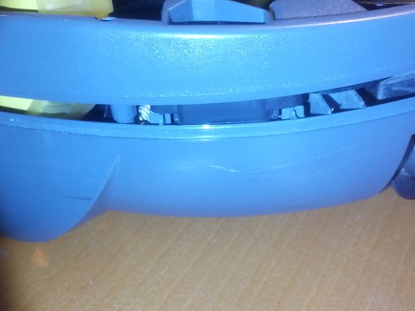

  13. Replace Kärcher RC3000 brush motor. replacement: crwdns2935265:013crwdnd2935265:01crwdnd2935265:02crwdne2935265:0 Replace Kärcher RC3000 brush motor. replacement: crwdns2935265:013crwdnd2935265:02crwdnd2935265:02crwdne2935265:0
    • The pins that must hold the spring must dip into the opposite frame part.
    • Only then can the frame be screwed on on this side.
    • The same on the other side.
    • Also install the remaining two screws. When tightening, ensure that the frames are evenly spaced apart.

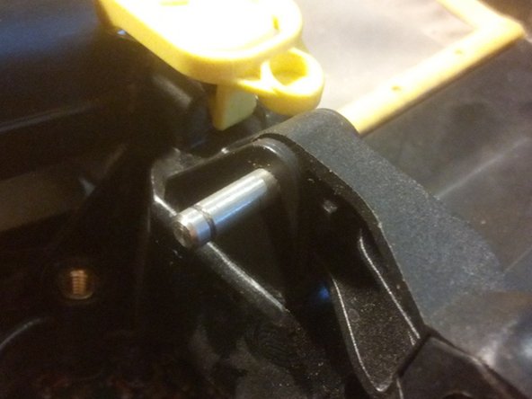

    • Reinsert the pins for the brush from the correct side.
  15. Replace Kärcher RC3000 brush motor. replacement: crwdns2935265:015crwdnd2935265:01crwdnd2935265:02crwdne2935265:0 Replace Kärcher RC3000 brush motor. replacement: crwdns2935265:015crwdnd2935265:02crwdnd2935265:02crwdne2935265:0
    • Insert pins to the end.
  16. Replace Kärcher RC3000 brush motor. replacement: crwdns2935265:016crwdnd2935265:01crwdnd2935265:02crwdne2935265:0 Replace Kärcher RC3000 brush motor. replacement: crwdns2935265:016crwdnd2935265:02crwdnd2935265:02crwdne2935265:0

    • Plug in the connector for the charging contacts
    • Plug for the on/off switch..

Danke - hat super geklappt! Vorsicht bei den weißen, dünnen Plastikstiften die den Bürstenmotor vorne noch begrenzen - brechen gerne ab.
