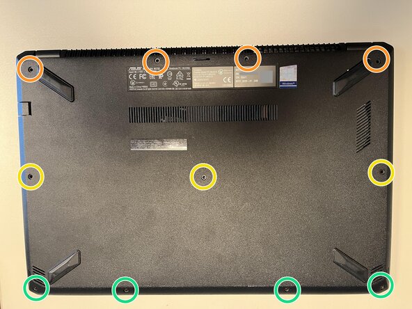

    • Close the laptop, place it on its lid, and align it as shown in the image
    • There are three different screw lengths:
    • 4 x PH1 12 mm (orange)
    • 3 x PH1 10 mm (yellow)
    • 4 x PH1 7 mm (green)
    • The screws must be reinstalled in the correct position later, otherwise something can be damaged.
    • Take out the screws and sort them by length.

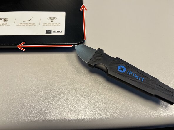

  2. Replace Asus M570D WiFi card or Bluetooth card, Remove the keyboard: crwdns2935265:02crwdnd2935265:01crwdnd2935265:01crwdne2935265:0
    • Turn the device over and open it.
    • Once the keyboard is detached, you must remove the 4 ribbon cables before you can remove the keyboard!
    • Carefully insert the Jimmy into the gap between the case and the keyboard at the lower right corner of the keyboard.
    • From this position, work your way forward by levering alternately to the left and up until the keyboard is loose on the case.
