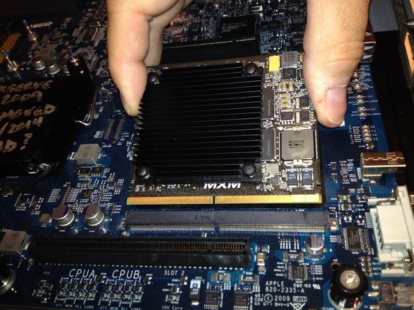

    • Remove the 2 screws that hold the video card on.
    • Slide the card out of the socket.
