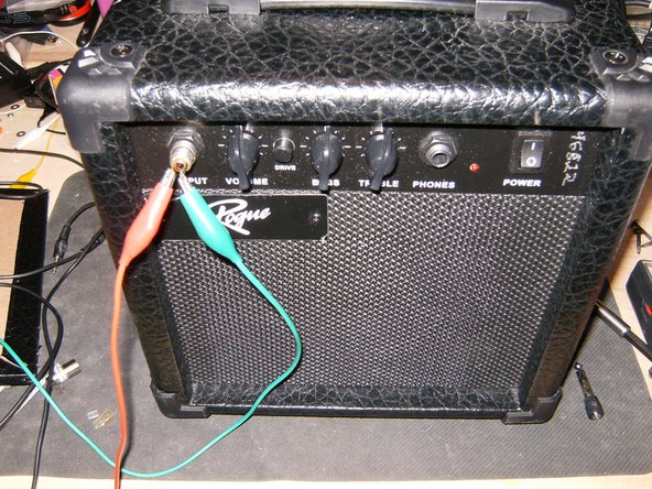

    • Here is the Amp in all its miniature glory. total size is 91/2 inches X 9 5/8inches and 6 inches deep. All controls are in the front panel.

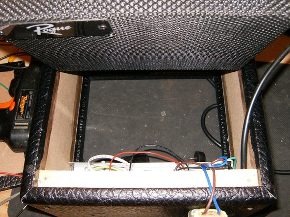

    • Remove the back panel. Use a small screwdriver, or other instrument to free it from its recess.
    • Work your way all around, since the back is a bit snug in the recess.
  3. Repairing the audio amplifier: crwdns2935265:03crwdnd2935265:01crwdnd2935265:03crwdne2935265:0 Repairing the audio amplifier: crwdns2935265:03crwdnd2935265:02crwdnd2935265:03crwdne2935265:0 Repairing the audio amplifier: crwdns2935265:03crwdnd2935265:03crwdnd2935265:03crwdne2935265:0
    • Once the panel is freed from the recess, fold it down and remove from amp.
    • Something does not look quite right :-)
    • the transformer should be mounted to the PCB, not laying inside the box.

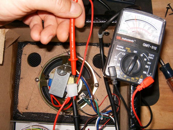

    • Before anything else, check the fuse for continuity. this one has failed.
  5. Repairing the audio amplifier: crwdns2935265:05crwdnd2935265:01crwdnd2935265:03crwdne2935265:0 Repairing the audio amplifier: crwdns2935265:05crwdnd2935265:02crwdnd2935265:03crwdne2935265:0 Repairing the audio amplifier: crwdns2935265:05crwdnd2935265:03crwdnd2935265:03crwdne2935265:0
    • Replace the fuse. Insert transformer power cable to PCB.
    • Since the Amp did not turn on, check the power out on the transformer. It does show 12V DC. Reconnect it and turn the Amp face forward.
    • The Amp uses a 6.3mm input and output jack. Apply a sound source to the input. Still no sound from the Amp, it is time to check a bit deeper.

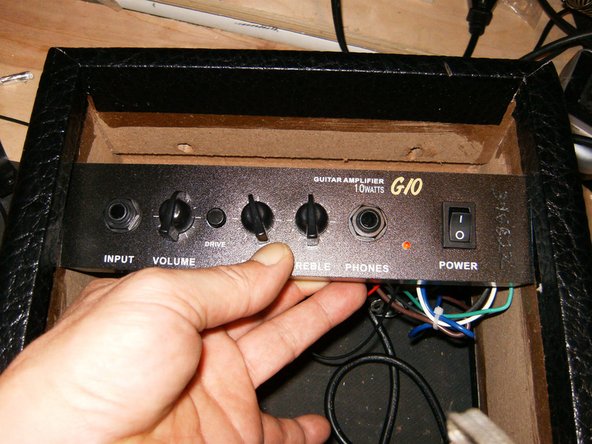

    • Remove the front panel and the attached speaker.
    • Simply lift it at an angle out of the back of the Amp.
    • The control panel and the attached PCB can now be removed.

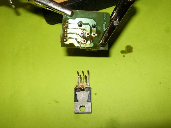

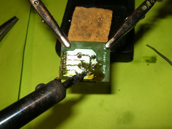

    • Remove the connector from the PCB.
    • Remove the IC PCB from the panel. The IC definitely shows some damage, most likely from overheating.
    • Here is a close up of the damaged IC. It is a TDA2030A 18 W hi-fi amplier / 35 W audio driver
  11. Repairing the audio amplifier: crwdns2935265:011crwdnd2935265:01crwdnd2935265:03crwdne2935265:0 Repairing the audio amplifier: crwdns2935265:011crwdnd2935265:02crwdnd2935265:03crwdne2935265:0 Repairing the audio amplifier: crwdns2935265:011crwdnd2935265:03crwdnd2935265:03crwdne2935265:0

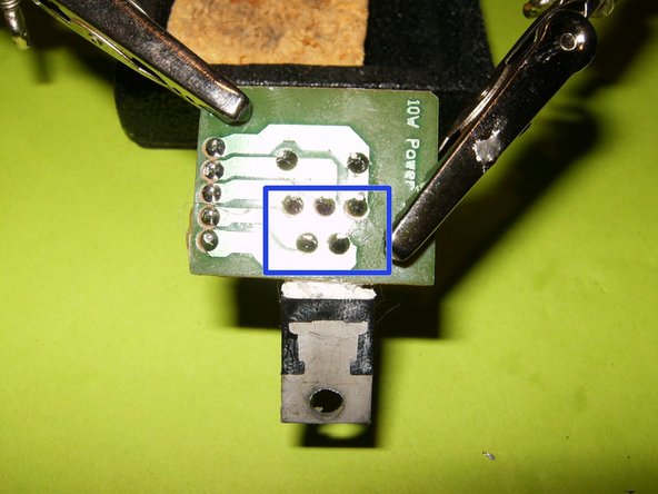

    • These are the tools needed to replace the IC. 15W Soldering iron, flux and desoldering wick.
    • These are the five contacts that need to be desoldered. Apply some flux on the wick and heat up the solder with the soldering iron.
    • Remove the damaged IC

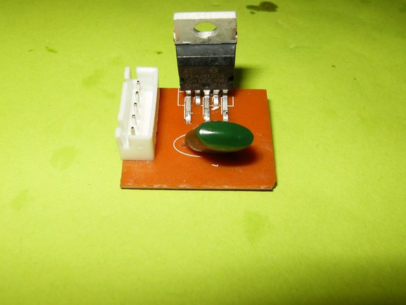

    • Here is the replacement IC.
    • Place the IC properly on the PCB
    • Solder it in place.
  14. Repairing the audio amplifier: crwdns2935265:014crwdnd2935265:01crwdnd2935265:02crwdne2935265:0 Repairing the audio amplifier: crwdns2935265:014crwdnd2935265:02crwdnd2935265:02crwdne2935265:0
    • Reapply a thin coat of thermal paste to the back of the IC. Use a self tapping screw to attach it to the heatsink.
    • Now is also a good time to properly mount the transformer. I used some M3x15mm machine screws.
    • With those repairs made, all that is left is to reassemble the AMP. In my case, this Amp worked after replacing the TDA2030A
