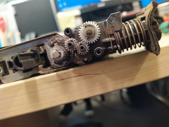

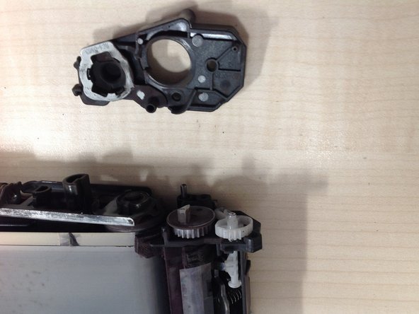

    • This is the part where re-assembly is most tricky, earning this guide a difficulty of "Difficult". Keep the cog wheels in the order that you remove them, and the same way round, ready for later re-assembly.
    • Remove the two 10mm screws that retain this cover then carefully remove the cover. Try to remove only the cover, leaving the cog wheels behind so that you can remove them individually and note the order.
    • Remove the 4 cog wheels.
    • Remove the metal frame that hooks the belt roller to the toner collector.

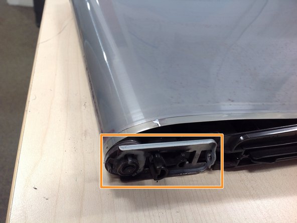

    • This is a view from underneath to give a clearer view of how the hook will look on re-assembly.

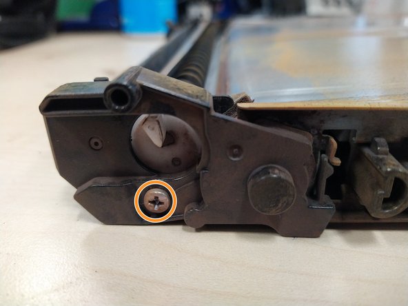

    • Before removing the cover on the second side, notice the position of the white plastic peg underneath. If this peg comes out it is easy to clip this peg back in the wrong place on re-assembly, then it will protrude outside the black plastic framework.
    • Remove the single 10mm screw then remove the cover.

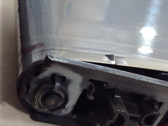

    • A closer inspection is now possible to identify the cause of the quality problems. Two different faults have been observed on the three units repaired so far.
    • In one case, the plastic wiper blade in the toner collection unit had a very visible kink. Replacement blades are available from Aliexpress. Fitting is a matter of releasing the two retaining springs and sliding the new wiper blade into place under the plastic Archimedes screw.
    • In two other cases, closer inspection of the belt shows a roughness as it passes over the roller that was pressing against the wiper blade. The close up view in the second picture shows this roughness. The remainder of this guide covers the repair of that fault.

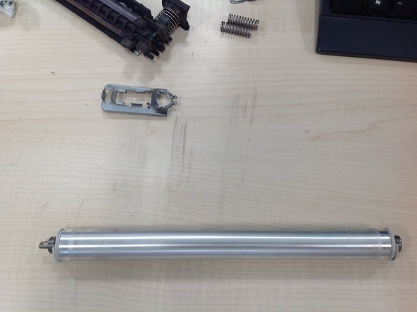

    • This metal frame can now be disconnected from the roller allowing the roller to be removed.
  9. Repairing the Intermediate Transfer Belt (ITB), Clean the front roller: crwdns2935265:010crwdnd2935265:01crwdnd2935265:02crwdne2935265:0 Repairing the Intermediate Transfer Belt (ITB), Clean the front roller: crwdns2935265:010crwdnd2935265:02crwdnd2935265:02crwdne2935265:0
    • The cause of the dirty printouts is now clearly revealed. The dark marks visible in the picture create the rough surface that prevents the wiper blade from cleaning the belt.
    • Isopropyl alcohol softens and removes most of this plastic, aided by a little scraping of the most resistant parts.
    • The second picture shows the cleaned roller with a smooth surface that enables the wiper blade to work correctly.
    • After re-assembly the quality problems were corrected on both the belts that were repaired in this way.
