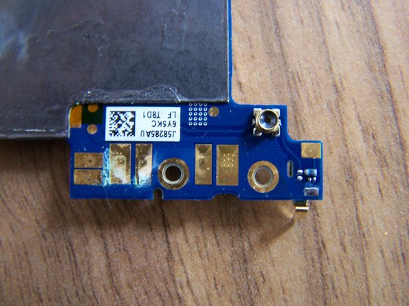

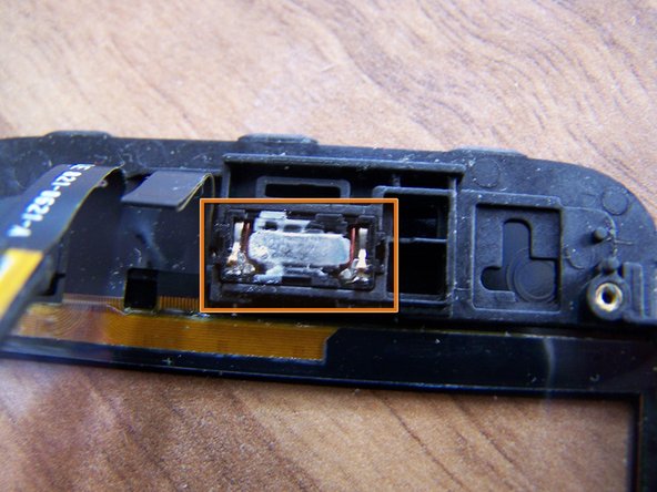

  5. Repairing iPhone Liquid Damage: crwdns2935265:05crwdnd2935265:01crwdnd2935265:03crwdne2935265:0 Repairing iPhone Liquid Damage: crwdns2935265:05crwdnd2935265:02crwdnd2935265:03crwdne2935265:0 Repairing iPhone Liquid Damage: crwdns2935265:05crwdnd2935265:03crwdnd2935265:03crwdne2935265:0
    • The rear of the display assembly shows more green corrosion and debris on the LCD and digitizer connectors.
    • Removing the LCD and the back cover of the ear speaker and proximity sensor assembly reveals liquid damage to the speaker.
    • The proximity sensor is only lightly damaged.

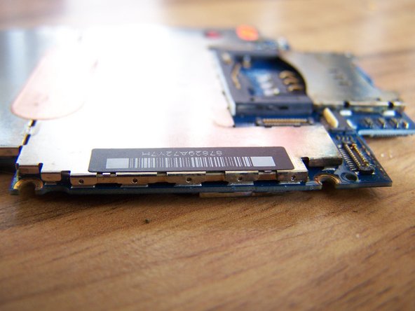

  10. Repairing iPhone Liquid Damage, Removing the logic board shield cover: crwdns2935265:010crwdnd2935265:01crwdnd2935265:02crwdne2935265:0 Repairing iPhone Liquid Damage, Removing the logic board shield cover: crwdns2935265:010crwdnd2935265:02crwdnd2935265:02crwdne2935265:0
    Spudger
    $3.99
    • Depending on the nature of the liquid damage, removing this shield may not be necessary, and doing so risks damaging the small components mounted on the logic board. If you decide to remove the shield, proceed cautiously and use a plastic tool such as a spudger, or a plastic opening tool to lever off the shield.
    • Look for the dimpled tabs on the shield that reach down over the tabs attached to the mother board.
    • Using your plastic tool, catch the edge of a dimpled tab near a corner of the shield, and pry it up away from the logic board.
    • Being careful of all the tiny surface mounted components, work your way around the available edges until the shield comes free.

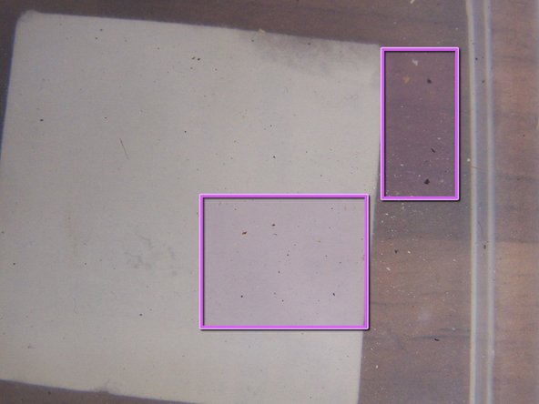

  11. Repairing iPhone Liquid Damage, Cleaning the logic board: crwdns2935265:011crwdnd2935265:01crwdnd2935265:02crwdne2935265:0 Repairing iPhone Liquid Damage, Cleaning the logic board: crwdns2935265:011crwdnd2935265:02crwdnd2935265:02crwdne2935265:0
    • Submerge the logic board in isopropyl alcohol, and allow it to soak long enough to loosen hardened residue, and to displace any remaining water or other liquid. Use a soft brush to remove visible corrosion and residue.
    • Residue from motherboard left in isopropyl alcohol container.
    • Clean all flex ends, battery contacts, connectors, chips, and fuses on motherboard with a soft brush.
    • Repeat cleaning if necessary, or if traces of residue are still visible.
    • Allow the logic board or other parts to dry completely before reassembly.
