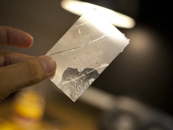

  31. Repairing iPhone 4 LCD Backlight Dim spot issue, Repairing iPhone 4 LCD Backlight Dim spot issue: crwdns2935265:031crwdnd2935265:01crwdnd2935265:01crwdne2935265:0
    • This is what the damage was. The digitiser was fine, the display was fine, but the backlight is damaged and dark patches exist.
    • As you can see, the screen was damaged by Acetone while trying to fix the home button. Some of it seeped in the screen because I tilted the device upside down.
  32. Repairing iPhone 4 LCD Backlight Dim spot issue: crwdns2935265:032crwdnd2935265:01crwdnd2935265:03crwdne2935265:0 Repairing iPhone 4 LCD Backlight Dim spot issue: crwdns2935265:032crwdnd2935265:02crwdnd2935265:03crwdne2935265:0 Repairing iPhone 4 LCD Backlight Dim spot issue: crwdns2935265:032crwdnd2935265:03crwdnd2935265:03crwdne2935265:0
    • I had no idea if I could fix it, I just wanted to find out what exactly was wrong.
    • Now that we have the screen out, the chrome with white border is a casing on the backlight, so I took it apart by peeling it off gently, by the white plastic frame.
    • Here we are, the chrome part is out, the backlight is naked and you see that transparent plastic part lying there. This is like a fibre optic transmitting light from the LEDs to the whole screen. This was damaged by the Acetone.
  33. Repairing iPhone 4 LCD Backlight Dim spot issue: crwdns2935265:033crwdnd2935265:01crwdnd2935265:02crwdne2935265:0 Repairing iPhone 4 LCD Backlight Dim spot issue: crwdns2935265:033crwdnd2935265:02crwdnd2935265:02crwdne2935265:0
    • This is the plastic part (ignore the crack, it was broken while taking it out). You can see the damage on the top, it looks as if someone spilled acid. Light transmission was obstructed to this area, hence the dim spots.
  34. Repairing iPhone 4 LCD Backlight Dim spot issue: crwdns2935265:034crwdnd2935265:01crwdnd2935265:02crwdne2935265:0 Repairing iPhone 4 LCD Backlight Dim spot issue: crwdns2935265:034crwdnd2935265:02crwdnd2935265:02crwdne2935265:0
    • I got this damaged iPhone 4 screen from a local repair guy. He gave it to me for free as it is of no use to him.
    • Make sure the back LCD/Backlight part isn't damaged or missing.
  35. Repairing iPhone 4 LCD Backlight Dim spot issue: crwdns2935265:035crwdnd2935265:01crwdnd2935265:03crwdne2935265:0 Repairing iPhone 4 LCD Backlight Dim spot issue: crwdns2935265:035crwdnd2935265:02crwdnd2935265:03crwdne2935265:0 Repairing iPhone 4 LCD Backlight Dim spot issue: crwdns2935265:035crwdnd2935265:03crwdnd2935265:03crwdne2935265:0
    • Remove the part, extract the fresh, non-damaged plastic backlight part from it.
    • Just replace the part and put everything back together with the chrome cover and plastic frame, and reassemble your phone.
    • Sure looks back to what it was - at least 95%. It's a job involving no cost at all! Worth the effort.
