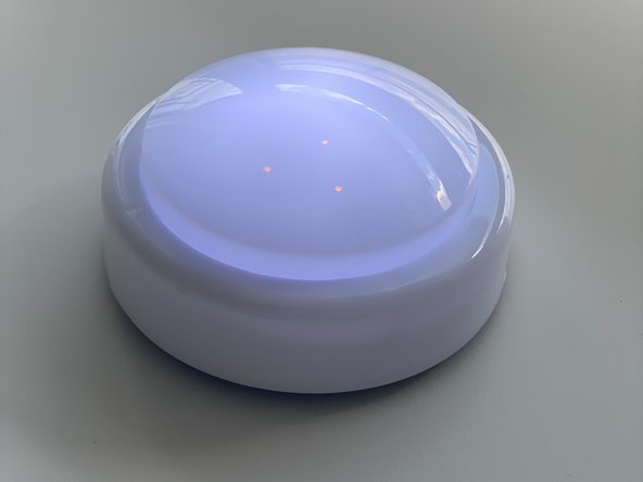

    • Lift the black lid off of the battery slot and remove the batteries.
  2. Repairing an FJ-3LED Globe Electric Push Light: crwdns2935265:02crwdnd2935265:01crwdnd2935265:03crwdne2935265:0 Repairing an FJ-3LED Globe Electric Push Light: crwdns2935265:02crwdnd2935265:02crwdnd2935265:03crwdne2935265:0 Repairing an FJ-3LED Globe Electric Push Light: crwdns2935265:02crwdnd2935265:03crwdnd2935265:03crwdne2935265:0
    • Use the Phillips #1 screwdriver to remove four 1.4 mm screws from the back of the light.
    • Take the black part out and separate it from the white case.

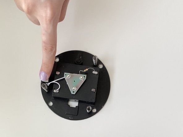

  3. Repairing an FJ-3LED Globe Electric Push Light: crwdns2935265:03crwdnd2935265:01crwdnd2935265:01crwdne2935265:0
    • Identify which part of the lamp is broken.
    • in this case, one of the connections in the circuit had been disconnected.
  4. Repairing an FJ-3LED Globe Electric Push Light: crwdns2935265:04crwdnd2935265:01crwdnd2935265:01crwdne2935265:0
    • For tips on Soldering, see How to Solder and Desolder Connections.
    • Attach the disconnected wire to its joint using solder and iron tip. Place the tip of the soldering iron against the solder pad.
    • Melt enough solder onto the solder pad.
    • Remove both the solder and the soldering iron tip from the connection as soon as enough solder melts onto the pad.
    • Don't forget to use gloves.
  5. Repairing an FJ-3LED Globe Electric Push Light: crwdns2935265:05crwdnd2935265:01crwdnd2935265:02crwdne2935265:0 Repairing an FJ-3LED Globe Electric Push Light: crwdns2935265:05crwdnd2935265:02crwdnd2935265:02crwdne2935265:0
    • Push the circuit into its place.
    • Click the button to see if the wires are connected .
  6. Repairing an FJ-3LED Globe Electric Push Light: crwdns2935265:06crwdnd2935265:01crwdnd2935265:02crwdne2935265:0 Repairing an FJ-3LED Globe Electric Push Light: crwdns2935265:06crwdnd2935265:02crwdnd2935265:02crwdne2935265:0
    • If the lights turn on, the connection is perfect in the circuit and the disconnected joint is now connected.
    • Place the white case on top of the circuit and close it with the Phillips #1 screwdriver.
