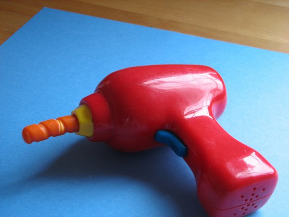

Repairing a plastic drill bit for a toy drill
  1. Repairing a plastic drill bit for a toy drill, Repairing a plastic drill bit for a toy drill: crwdns2935265:01crwdnd2935265:01crwdnd2935265:01crwdne2935265:0
    • Match up the broken plastic part and check that the pieces align.
    • The plastic part was hollow and had space to insert the wood support.
  2. Repairing a plastic drill bit for a toy drill: crwdns2935265:02crwdnd2935265:01crwdnd2935265:01crwdne2935265:0
    • Tools needed:
    • - Glue (Super glue, Wood Glue or Tacky glue)
    • - A bamboo chopstick from your favorite chinese restaurant
  3. Repairing a plastic drill bit for a toy drill: crwdns2935265:03crwdnd2935265:01crwdnd2935265:01crwdne2935265:0
    • Cut the chopstick to the required size using a sharp knife.
    • Some trimming and shaving may be needed depending on the plastic part and the wooden dowel with the objective of to get a tight fit.
  4. Repairing a plastic drill bit for a toy drill: crwdns2935265:04crwdnd2935265:01crwdnd2935265:01crwdne2935265:0
    • Apply a drop of glue to the ends of the wooden dowel.
  5. Repairing a plastic drill bit for a toy drill: crwdns2935265:05crwdnd2935265:01crwdnd2935265:01crwdne2935265:0
    • Insert the wooden dowel into one part of the broken plastic part.
  6. Repairing a plastic drill bit for a toy drill: crwdns2935265:06crwdnd2935265:01crwdnd2935265:02crwdne2935265:0 Repairing a plastic drill bit for a toy drill: crwdns2935265:06crwdnd2935265:02crwdnd2935265:02crwdne2935265:0
    • Insert the other end of the wooden dowel into the other end of the plastic toy.
    • Push the ends together to get a tight and clean fit.
