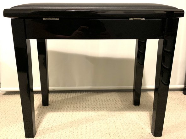

Repairing a Wobbly Piano Bench
  1. Repairing a Wobbly Piano Bench, Repairing a Wobbly Piano Bench: crwdns2935265:01crwdnd2935265:01crwdnd2935265:01crwdne2935265:0

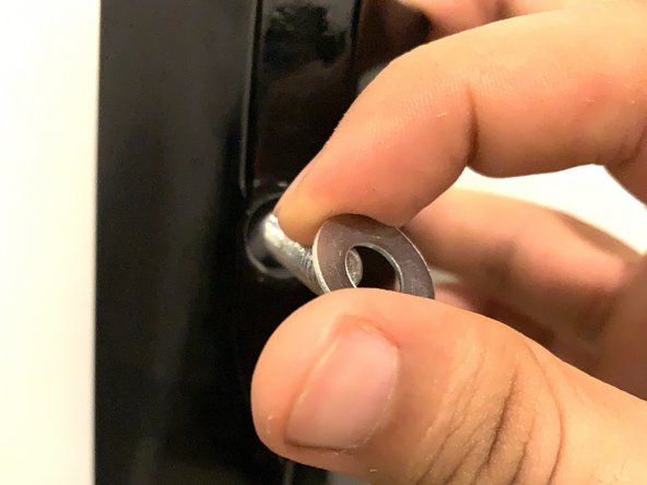

    • Place the bench on an even surface.
  2. Repairing a Wobbly Piano Bench: crwdns2935265:02crwdnd2935265:01crwdnd2935265:01crwdne2935265:0
    • Open and lock its lid. Make sure it stays open during the whole procedure.
  3. Repairing a Wobbly Piano Bench: crwdns2935265:03crwdnd2935265:01crwdnd2935265:03crwdne2935265:0 Repairing a Wobbly Piano Bench: crwdns2935265:03crwdnd2935265:02crwdnd2935265:03crwdne2935265:0 Repairing a Wobbly Piano Bench: crwdns2935265:03crwdnd2935265:03crwdnd2935265:03crwdne2935265:0

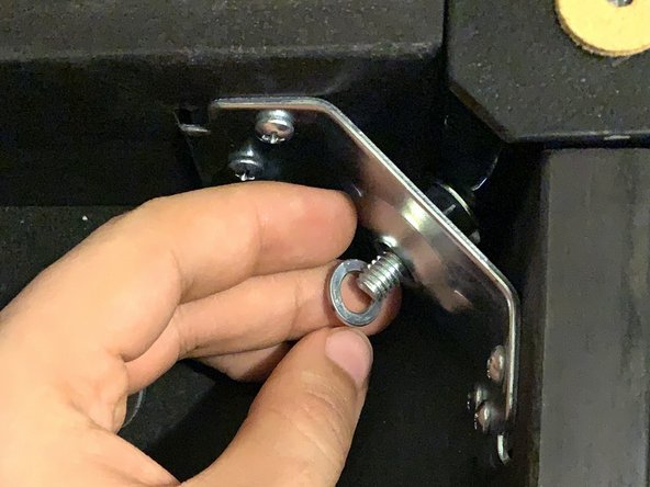

    • Unscrew the outer hex nut from one leg using the wrench and take the lock washer out.
  4. Repairing a Wobbly Piano Bench: crwdns2935265:04crwdnd2935265:01crwdnd2935265:03crwdne2935265:0 Repairing a Wobbly Piano Bench: crwdns2935265:04crwdnd2935265:02crwdnd2935265:03crwdne2935265:0 Repairing a Wobbly Piano Bench: crwdns2935265:04crwdnd2935265:03crwdnd2935265:03crwdne2935265:0

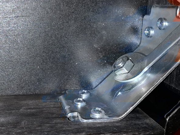

    • Take the leg out and unscrew the inner hex nut.
    • Replace the washers with the new ones and re-screw the hex nut tightly.

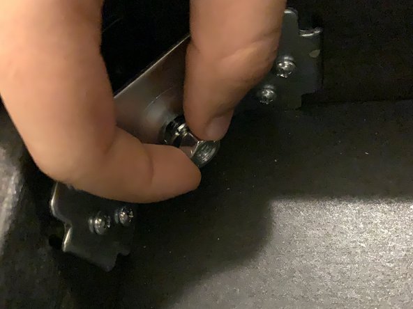

  5. Repairing a Wobbly Piano Bench: crwdns2935265:05crwdnd2935265:01crwdnd2935265:01crwdne2935265:0
    • Connect the leg to the bench again using the new lock washer.
    • Screw the hex nut a few rounds, but do not tighten it yet.
    • Repeat Steps 3 through 5 for all four legs.

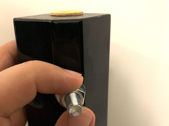

  6. Repairing a Wobbly Piano Bench: crwdns2935265:06crwdnd2935265:01crwdnd2935265:02crwdne2935265:0 Repairing a Wobbly Piano Bench: crwdns2935265:06crwdnd2935265:02crwdnd2935265:02crwdne2935265:0
    • Add a little weight to the chair or push it down with two hands.
    • Turn all four outer hex nuts one round.
    • Make sure the bench is balanced and repeat until all hex nuts are tight.
  7. Repairing a Wobbly Piano Bench: crwdns2935265:07crwdnd2935265:01crwdnd2935265:02crwdne2935265:0 Repairing a Wobbly Piano Bench: crwdns2935265:07crwdnd2935265:02crwdnd2935265:02crwdne2935265:0
    • Close the lid seat on the chair.
    • If the chair is not balanced or if it makes noises, unscrew the outer nut two rounds and repeat Step 6.
You can redo this process every 6 months to make sure your bench is always stable.
