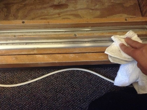

    • Run screw driver through the bottom track to clear any debris.
    • Spray a mixture of WD-40 and cleaning solution onto a clean rag.
    • Wipe down the track with the rag.

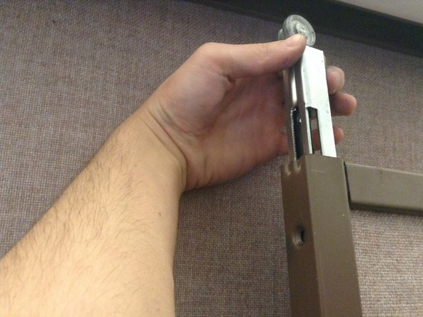

    • Locate the 2 rollers hanging from the top track.
    • Pull the 2 rollers to the opposite ends of the track.
    • Push the roller up and away from yourself and it should come right off. Repeat this process for the other roller.

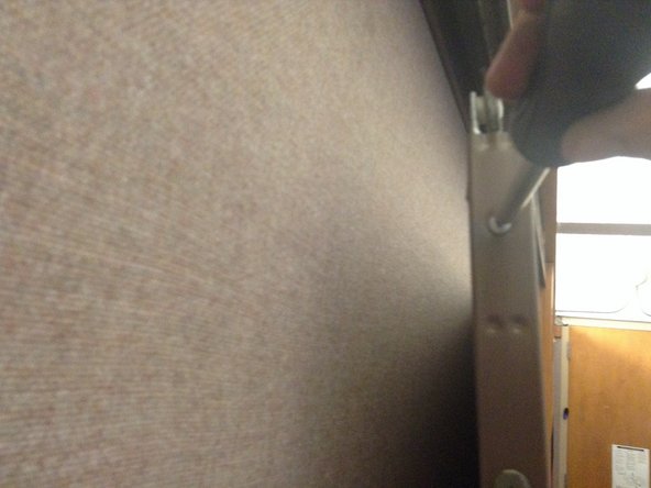

  8. Repairing a Sliding Closet Door: crwdns2935265:08crwdnd2935265:01crwdnd2935265:02crwdne2935265:0 Repairing a Sliding Closet Door: crwdns2935265:08crwdnd2935265:02crwdnd2935265:02crwdne2935265:0
    • Screw the the 2 screws you took out in step 1 back in.
    • Turn the screws clockwise to tighten
