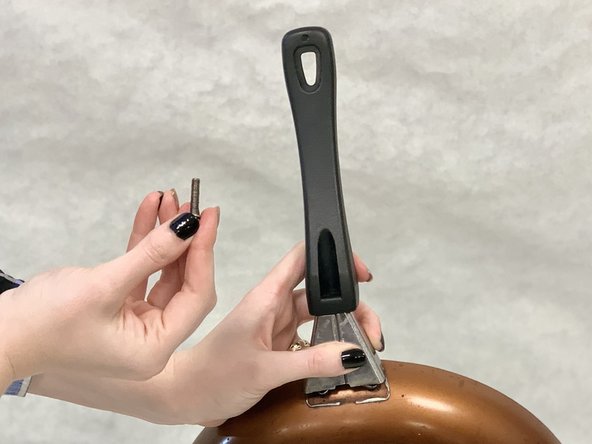

    • Identify the screw keeping the handle in place.
    • Most screws are located on the underside, and a typical pan has only one screw. If there are more, locate them as well.
    • Use a standard Phillips screwdriver to remove the screw(s).

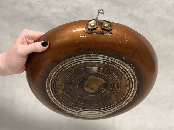

    • Remove the handle and the metal bar to expose the base of the pan handle.
    • The base is where the full handle and the pan meet.

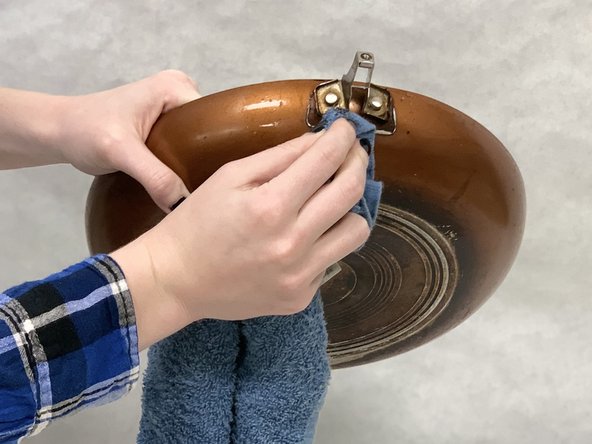

    • Determine what kind of cleaning is required. I used a Lysol solution, which can be substituted with soap and water.
    • If there is rust or burn marks, there are two guides on iFixit by other creators that work well. Their links can be followed by their respective words.
    • Apply your cleaning solution to the base.
    • If necessary, apply cleaning solution to the handle and metal bar, as well.
    • Wipe the area until it is clean, repeat if necessary.

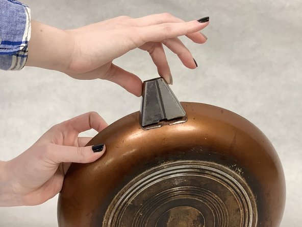

    • Identify the warp on the pan, if any.
    • Warps can impact the handle, making it loose or rest incorrectly. This can occur with even small warps, so look closely at your pan.
    • Set the pan on top of a flat cloth.
    • If the warp is going in towards the pan, lay it down with the inside of the pan facing up. If the warp is going out away from the pan, lay it down with the bottom of the pan facing up.
