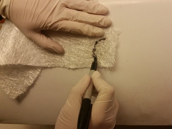

    • Once dry, it is time to move onto the front side of the hole.
    • Use the sharpie to carefully outline the shape of the hole and then cut out the shape with your scissors, again making multiple layers.
    • It is important to outline the shape because you want the end result to be flush with the existing surface unlike the back side of the hole.

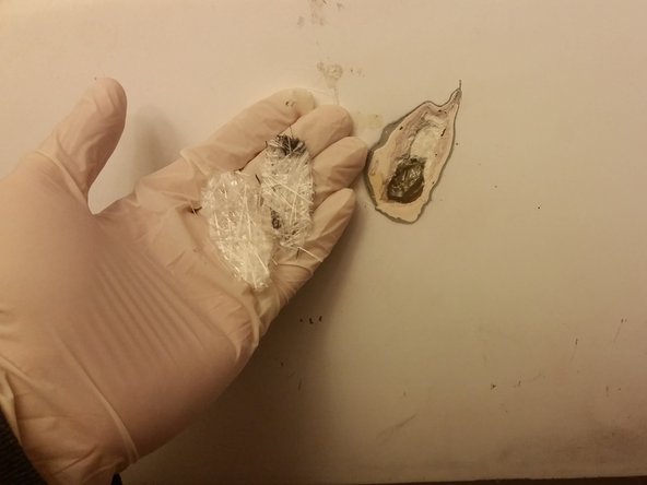

  10. Repairing a Hole in a Fiber Glass Jet Ski Body: crwdns2935265:010crwdnd2935265:01crwdnd2935265:03crwdne2935265:0 Repairing a Hole in a Fiber Glass Jet Ski Body: crwdns2935265:010crwdnd2935265:02crwdnd2935265:03crwdne2935265:0 Repairing a Hole in a Fiber Glass Jet Ski Body: crwdns2935265:010crwdnd2935265:03crwdnd2935265:03crwdne2935265:0
    • After you have again mixed your resin, begin by applying a small layer to the inside of the hole only.
    • Place your fiberglass piece onto the resin in the hole, and then continue to coat the layer in resin until soaked.
    • Continue this process with all layers until resin surface is flush with existing surface.
    • Again, let the resin dry for the designated period of time provided on the back of the resin container.

An old boat repairman's trick to make the fiberglass mat patch blend in with the surrounding area (if it will show-- which it doesn't in the repair on the jet ski): Tear the mat, rather than cut it. The torn edge tapers to nothing while a cut edge is abrupt and will show more obviously as a patch.
If you add enough fiberglass mat on the back side to make your patch strong enough there's no need to add more fiberglass on the front side. Use Bondo to fill the hole on the front. It can be smoothed with a putty knife and easily sanded flush with ease after it solidifies, which only takes minutes.
