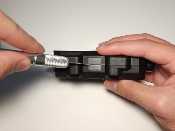

  4. Repairing a Clogged MakerBot Smart Extruder+: crwdns2935265:04crwdnd2935265:01crwdnd2935265:02crwdne2935265:0 Repairing a Clogged MakerBot Smart Extruder+: crwdns2935265:04crwdnd2935265:02crwdnd2935265:02crwdne2935265:0

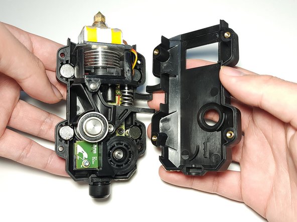

    • Turn the extruder on its side and cut through the black seal using the X-ACTO Knife.

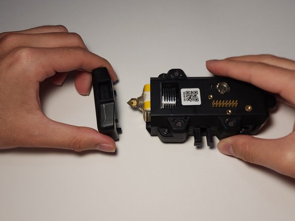

  5. Repairing a Clogged MakerBot Smart Extruder+: crwdns2935265:05crwdnd2935265:01crwdnd2935265:02crwdne2935265:0 Repairing a Clogged MakerBot Smart Extruder+: crwdns2935265:05crwdnd2935265:02crwdnd2935265:02crwdne2935265:0
    • Gently pull the two halves of the extruder apart.

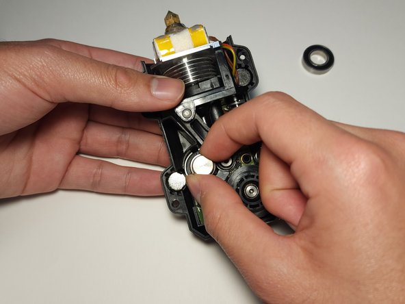

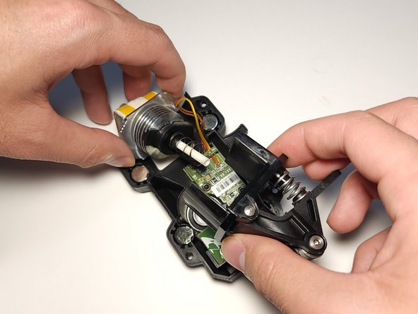

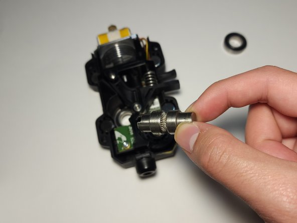

  6. Repairing a Clogged MakerBot Smart Extruder+: crwdns2935265:06crwdnd2935265:01crwdnd2935265:03crwdne2935265:0 Repairing a Clogged MakerBot Smart Extruder+: crwdns2935265:06crwdnd2935265:02crwdnd2935265:03crwdne2935265:0 Repairing a Clogged MakerBot Smart Extruder+: crwdns2935265:06crwdnd2935265:03crwdnd2935265:03crwdne2935265:0
    • Remove the bearing and the hobbed bolt.

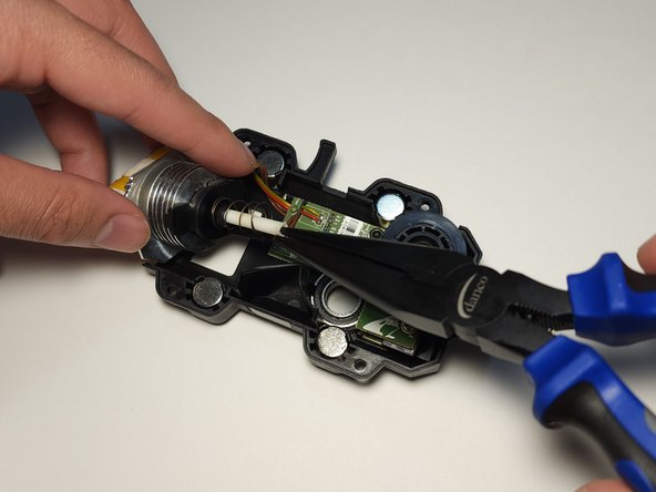

  7. Repairing a Clogged MakerBot Smart Extruder+: crwdns2935265:07crwdnd2935265:01crwdnd2935265:03crwdne2935265:0 Repairing a Clogged MakerBot Smart Extruder+: crwdns2935265:07crwdnd2935265:02crwdnd2935265:03crwdne2935265:0 Repairing a Clogged MakerBot Smart Extruder+: crwdns2935265:07crwdnd2935265:03crwdnd2935265:03crwdne2935265:0
    • Remove the freed nozzle and use needle nose pliers to pull out the filament that is clogging the extruder.
