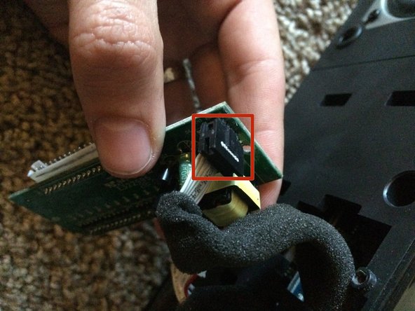

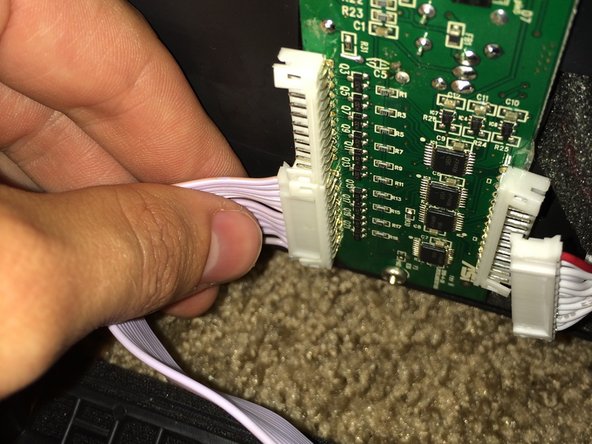

    • Start by carefully removing the cable on the right.
  4. Repairing Vizio VHT 510 Sound Bar Volume Indicator LED: crwdns2935265:04crwdnd2935265:01crwdnd2935265:03crwdne2935265:0 Repairing Vizio VHT 510 Sound Bar Volume Indicator LED: crwdns2935265:04crwdnd2935265:02crwdnd2935265:03crwdne2935265:0 Repairing Vizio VHT 510 Sound Bar Volume Indicator LED: crwdns2935265:04crwdnd2935265:03crwdnd2935265:03crwdne2935265:0

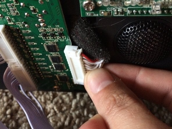

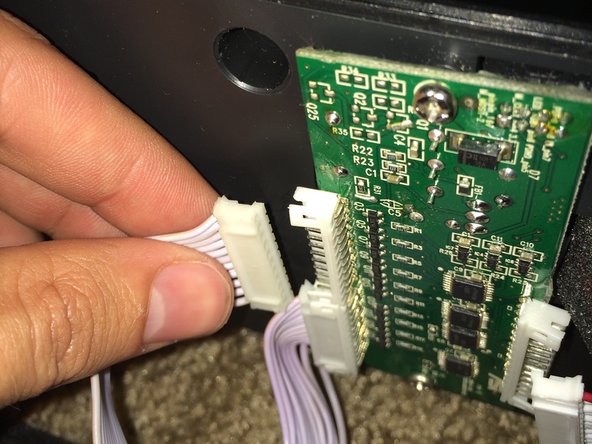

    • Disconnect the two cables attached to the grille.
  5. Repairing Vizio VHT 510 Sound Bar Volume Indicator LED: crwdns2935265:05crwdnd2935265:01crwdnd2935265:03crwdne2935265:0 Repairing Vizio VHT 510 Sound Bar Volume Indicator LED: crwdns2935265:05crwdnd2935265:02crwdnd2935265:03crwdne2935265:0 Repairing Vizio VHT 510 Sound Bar Volume Indicator LED: crwdns2935265:05crwdnd2935265:03crwdnd2935265:03crwdne2935265:0

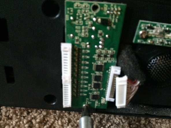

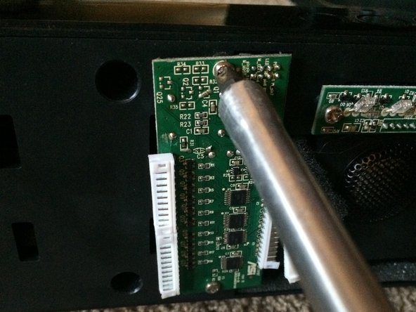

    • Remove the two screws holding the led controller in place.
  6. Repairing Vizio VHT 510 Sound Bar Volume Indicator LED: crwdns2935265:06crwdnd2935265:01crwdnd2935265:03crwdne2935265:0 Repairing Vizio VHT 510 Sound Bar Volume Indicator LED: crwdns2935265:06crwdnd2935265:02crwdnd2935265:03crwdne2935265:0 Repairing Vizio VHT 510 Sound Bar Volume Indicator LED: crwdns2935265:06crwdnd2935265:03crwdnd2935265:03crwdne2935265:0

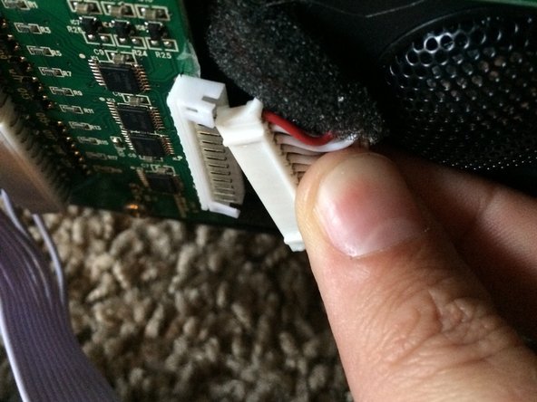

    • Pull the board out toward you to disconnect the final cable.
    • Pull the final cable outwards to release the board.

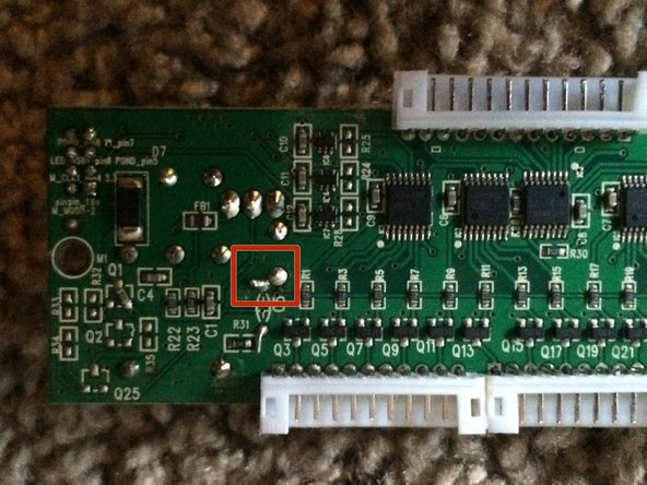

    • On the bottom of the board you will see these two components.
    • The capacitor and resistor on the right are what we will focus on.
    • Find the leg of the capacitor and the leg of the resistor that are closest to one another.
    • Turn the board over and look at the solder points for those two legs.
  8. Repairing Vizio VHT 510 Sound Bar Volume Indicator LED: crwdns2935265:08crwdnd2935265:01crwdnd2935265:01crwdne2935265:0
    • The solder points are extremely close and if they are in contact the leds will stop working.
    • With your soldering iron, heat each leg individually and attempt to make more space between the two points.
    • This process can take time so don't worry if the solder points come together. Just keep heating one up at a time and try to create a gap.

    • One final note. I did notice that disconnecting and reseating the two cables connected to the speaker grill while the speaker is powered on will sometimes get the leds to start working. I hope this helps someone.

Pics please, i tried to figure out the cap and resistor being talked about.
However their solder points were close but to the naked eye they didnt seem to be connected. Also however hard i tried, i could always test it postive for connectivity using a Digital MultiMeter. It seems they were designed to be on the same PCB track or connected or something..
Pics would be really helpful as this affects nearly all of the VHT 510 users... thanks
Mogambo - crwdns2934203:0crwdne2934203:0
Let me know if these photos help. I'm not an electrician but this is how I fixed my sound bar.
Johnny -
