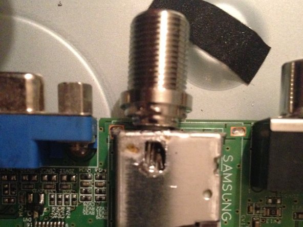

Repairing Vizio Television  Cable Connection
Having problems with your cable connection? Has replacing the cable failed to fix the problem? You may have a broken connection in your motherboard. This guide will help you repair a broken connection from the cable to the motherboard.
    1. Repairing Vizio Television  Cable Connection, Repairing Vizio Television  Cable Connection: crwdns2935265:01crwdnd2935265:01crwdnd2935265:01crwdne2935265:0
      • First, remove the (20) Phillips screws from the back plate. If your television is mounted against a wall, you'll have to remove it from your wall mounting bracket as well.
      • Don't forget the 2 Phillips screws in the motherboard area (circled in red).
    2. Repairing Vizio Television  Cable Connection: crwdns2935265:02crwdnd2935265:01crwdnd2935265:03crwdne2935265:0 Repairing Vizio Television  Cable Connection: crwdns2935265:02crwdnd2935265:02crwdnd2935265:03crwdne2935265:0 Repairing Vizio Television  Cable Connection: crwdns2935265:02crwdnd2935265:03crwdnd2935265:03crwdne2935265:0
      • After removing the back plate, you'll see some circuit boards. We'll be focusing on the motherboard to the right.
      • (2) Phillips screws hold down covers over your inputs.
      • Note this screw holds down both covers where they overlap.
      • The bottom cover will not move until the 2 small Phillips screws are removed.
    3. Repairing Vizio Television  Cable Connection: crwdns2935265:03crwdnd2935265:01crwdnd2935265:02crwdne2935265:0 Repairing Vizio Television  Cable Connection: crwdns2935265:03crwdnd2935265:02crwdnd2935265:02crwdne2935265:0
      • Once the covers are all removed, you'll see a big hole where the cable connection is supposed to be.
      • Proceed to solder your new connection in like I did here. If you decide to replace the entire part you'll need to remove the motherboard... We'll save that for a different thread.
    4. Repairing Vizio Television  Cable Connection: crwdns2935265:04crwdnd2935265:01crwdnd2935265:01crwdne2935265:0
      • You can then put it all back together once again in reverse order and enjoy some cable TV!
