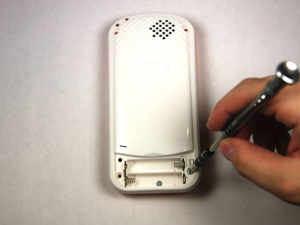

    • Using a Phillips #1 screwdriver, remove the 4.8mm screw on the battery cover by twisting the screwdriver counter-clockwise.

    • Remove the two AAA batteries by pulling on one end of the battery and lifting it straight out.

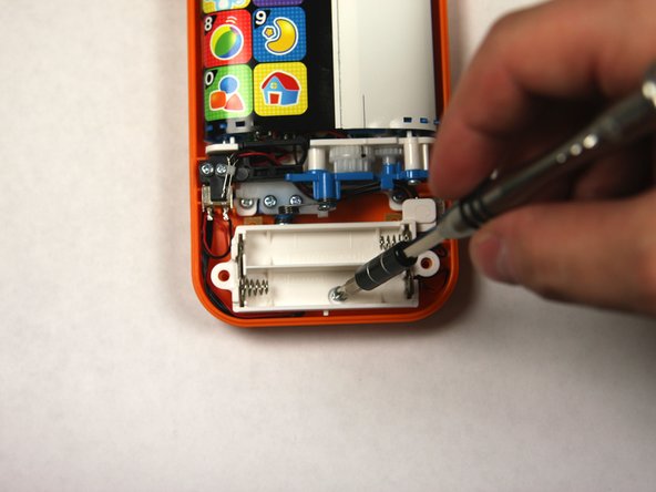

    • Remove four 13.8mm screws from the back of the device using a Phillips #1 screwdriver.
  5. Repairing VTech Touch and Swipe Baby Phone Screen Alignment: crwdns2935265:05crwdnd2935265:01crwdnd2935265:03crwdne2935265:0 Repairing VTech Touch and Swipe Baby Phone Screen Alignment: crwdns2935265:05crwdnd2935265:02crwdnd2935265:03crwdne2935265:0 Repairing VTech Touch and Swipe Baby Phone Screen Alignment: crwdns2935265:05crwdnd2935265:03crwdnd2935265:03crwdne2935265:0

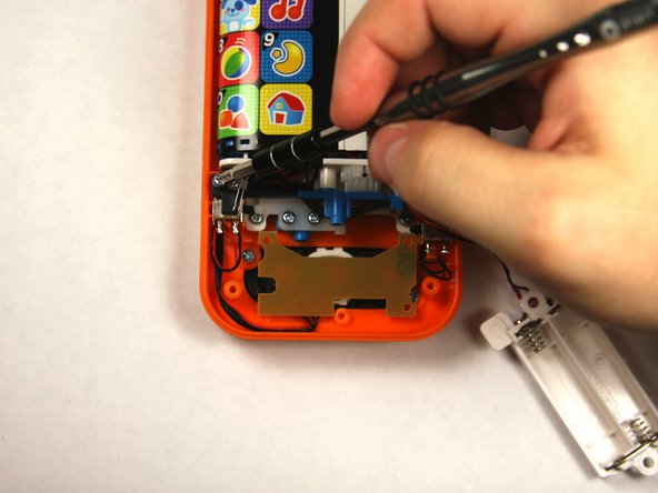

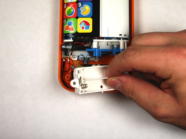

    • Remove a single 4.8 mm screw with a Phillips #0 screwdriver and lift away the battery pack being careful of the wires.
  6. Repairing VTech Touch and Swipe Baby Phone Screen Alignment: crwdns2935265:06crwdnd2935265:01crwdnd2935265:02crwdne2935265:0 Repairing VTech Touch and Swipe Baby Phone Screen Alignment: crwdns2935265:06crwdnd2935265:02crwdnd2935265:02crwdne2935265:0

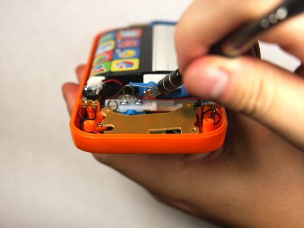

    • Remove two 7.2 mm screws with a Phillips #0 screwdriver.
    • Slide off the spring.

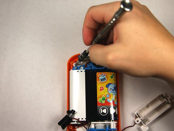

  7. Repairing VTech Touch and Swipe Baby Phone Screen Alignment: crwdns2935265:07crwdnd2935265:01crwdnd2935265:03crwdne2935265:0 Repairing VTech Touch and Swipe Baby Phone Screen Alignment: crwdns2935265:07crwdnd2935265:02crwdnd2935265:03crwdne2935265:0 Repairing VTech Touch and Swipe Baby Phone Screen Alignment: crwdns2935265:07crwdnd2935265:03crwdnd2935265:03crwdne2935265:0
    • Remove the single 7.5mm screw with a Phillips #0 screwdriver.
    • Lift up the black plastic piece.

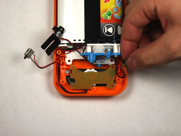

    • Remove the two buttons, noting how wires are placed for reassembly.
  10. Repairing VTech Touch and Swipe Baby Phone Screen Alignment: crwdns2935265:010crwdnd2935265:01crwdnd2935265:02crwdne2935265:0 Repairing VTech Touch and Swipe Baby Phone Screen Alignment: crwdns2935265:010crwdnd2935265:02crwdnd2935265:02crwdne2935265:0
    • Lift the button board up and away to clear room for lifting the motherboard.

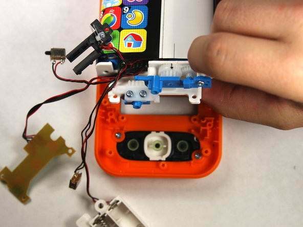

    • Tilt the assembly up but being wary that it is still attached to the front panel.
  11. Repairing VTech Touch and Swipe Baby Phone Screen Alignment: crwdns2935265:011crwdnd2935265:01crwdnd2935265:01crwdne2935265:0
    • Slide the toothed slider towards you to remove.
  12. Repairing VTech Touch and Swipe Baby Phone Screen Alignment: crwdns2935265:012crwdnd2935265:01crwdnd2935265:01crwdne2935265:0
    • To reassemble, align the two black lines together by moving the belt back and forth.
    • Once aligned reinsert the toothed slider at the exact point shown.
To reassemble your device, follow these instructions in reverse order, skipping step 10 as the toothed slider has already been put in for proper alignment.
