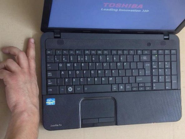

    • Switch-off the laptop and remove the battery.

Can't you just leave fan assembly installed and start cleaning it with brush and compressed air once you have bottom case cover off? What about just blowing air thru the grill covering the fan and not even removing the bottom case cover?
