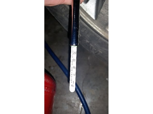

    • Using the air compressor, air the tire up to the original recommended weight for the vehicle.
    • Air is expected to continue to leak out so do not worry if you cannot get it perfect.

    • Use the air pressure gauge to make sure the tire is now aired up to its original pressure.

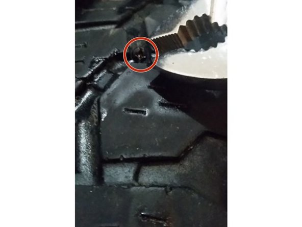

  4. Repairing Tire Hole/Puncture: crwdns2935265:04crwdnd2935265:01crwdnd2935265:01crwdne2935265:0
    • Spray the surface of the tire completely with the soapy water.
  5. Repairing Tire Hole/Puncture: crwdns2935265:05crwdnd2935265:01crwdnd2935265:01crwdne2935265:0
    • Look for tiny air bubbles forming from the leaking air and soap combination, this is where the hole is located.

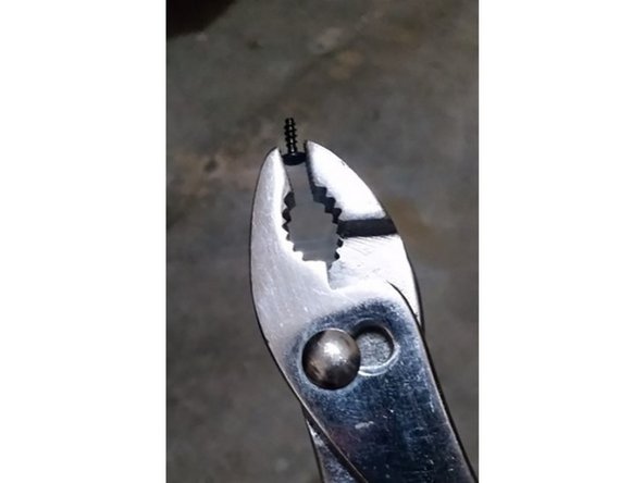

  6. Repairing Tire Hole/Puncture: crwdns2935265:06crwdnd2935265:01crwdnd2935265:03crwdne2935265:0 Repairing Tire Hole/Puncture: crwdns2935265:06crwdnd2935265:02crwdnd2935265:03crwdne2935265:0 Repairing Tire Hole/Puncture: crwdns2935265:06crwdnd2935265:03crwdnd2935265:03crwdne2935265:0
    • Once the hole is located, remove any foreign objects with the pliers if present.
    • Any object that is stuck in the tire, or puncturing the tire is considered a foreign object. These may include sharp objects, commonly seen as nails, screws, or pieces of metal.

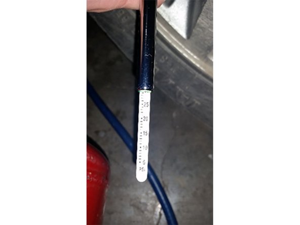

    • Refill the tire to the proper pressure.
  11. Repairing Tire Hole/Puncture: crwdns2935265:011crwdnd2935265:01crwdnd2935265:02crwdne2935265:0 Repairing Tire Hole/Puncture: crwdns2935265:011crwdnd2935265:02crwdnd2935265:02crwdne2935265:0
    • Use the air pressure gauge to make sure that the tire is back to its original air pressure.
