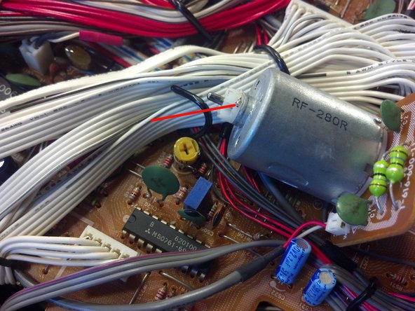

  5. Repairing Sony SL-HF750 Open/Eject Mechinism: crwdns2935265:05crwdnd2935265:01crwdnd2935265:01crwdne2935265:0
    • Now mark the motor with a sharpie so you know how it lines up when putting it back together. Trust me, it seems trivial, but you will thank me later.

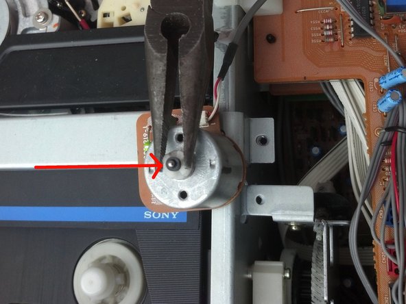

  6. Repairing Sony SL-HF750 Open/Eject Mechinism: crwdns2935265:06crwdnd2935265:01crwdnd2935265:03crwdne2935265:0 Repairing Sony SL-HF750 Open/Eject Mechinism: crwdns2935265:06crwdnd2935265:02crwdnd2935265:03crwdne2935265:0 Repairing Sony SL-HF750 Open/Eject Mechinism: crwdns2935265:06crwdnd2935265:03crwdnd2935265:03crwdne2935265:0
    • Now remove the motor mounting screws with a philips #1.
    • You will have to come in at an angle and use some pressure to assure it won't strip the screw.
    • Its normal to slightly damage(by slipping) the screws in the process. Being patient and aware will minimize that.

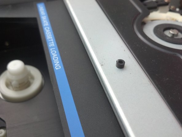

    • Remove the rubber washer. Put it somewhere safe!!! NOT like I did :)

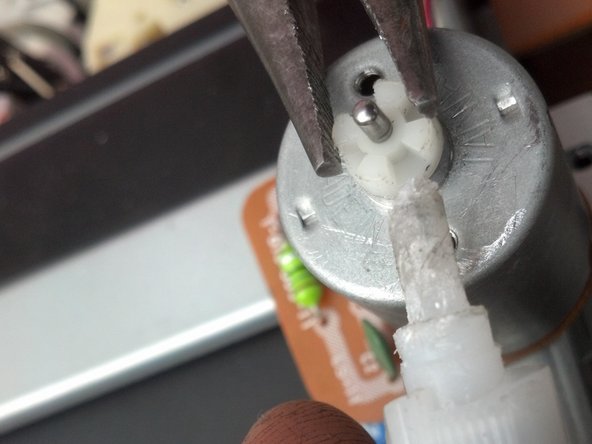

    • First, its probably a good idea to clean the crack first with some alcohol, just in case there is any lubricant leftover on there as it will prevent the glue from adhering well.
    • Next get a pair of needle nose pliers(preferably ones with grooved "teeth") Then wrap a rubber band around them so they hold tension. The tension should be something you can fight against, but not so tight it may crack the gear.
    • Fill in the crack with a little bit of super glue. Then use the pliers to push the crack in the gear back together slightly.
    • Necessary NOTE: Use a thicker type of super glue. I recommend Loctite gel type. If its too thin it will get in the motor bearing, then you are SOL. Also a little bit goes along way. I used a dental pick to work it into the crack.
    • I also wanna reiterate NOT to get glue on the Bottom of the gear or onto the main part of the motor. IF you do, immediately remove it before it dries. There is super glue remover available, but I find if a little gets in the way, just turn the shaft to break it free and clean it with an Exacto knife.

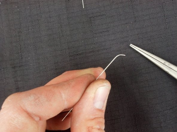

    • While the super glue dries, find an old leaded component, resistor, capacitor, or a diode, whatever, then shape it to the roundness of the broken gear as you are now going to melt it into it. Yes, melt it into. Once shaped "tin" the lead with some solder as it will help heat flow.
    • Now heat the component lead. Then line it up so it is perpendicular to the crack and equally spaced on both sides of the crack.
    • Melt it evenly and gently into the gear across the crack. Try to only press it in 1-2mm, so most of it is beyond the edge of the gear, but don't push it in too far that it touches the shaft.
    • Let it cool for 3-5 seconds and then move. Moving beforehand may weaken the bond between the metal and plastic.
    • Necessary note: This is an art and may take time to get right, I highly suggest practicing with other plastic pieces you care less about first. Plan your attempts first. Its not quite a do or die thing, but you will start to render the plastic useless if you do not properly insert the lead.

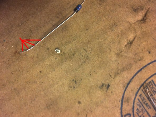

    • Heres a before and after image. Once again heat the lead, pull it in and then it will end up lodged into the plastic, making it stronger than it was before. Once the heat has dissipated(10 secs), cut the excess leads off.
    • You can now see the lead imbedded within the plastic.
