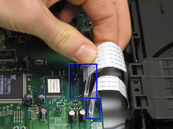

    • Remove the two white ribbon cables that connect the motherboard and the disc tray by pulling on the ribbon cable where it attaches to the circuit board.

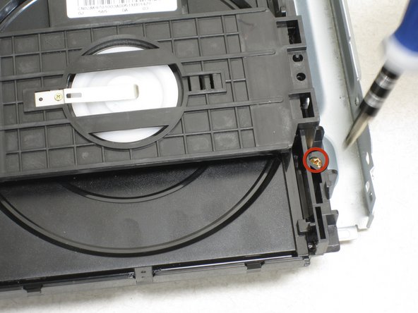

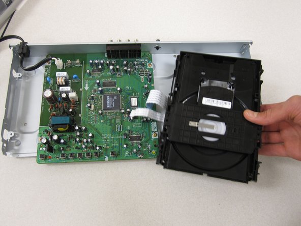

    • Remove the three 0.6 cm gold screws holding the disc tray to the bottom casing with a Philips #1 screwdriver.
    • Lift the disc tray out.

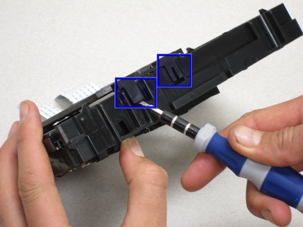

  9. Repairing Samsung P241 Laser: crwdns2935265:09crwdnd2935265:01crwdnd2935265:03crwdne2935265:0 Repairing Samsung P241 Laser: crwdns2935265:09crwdnd2935265:02crwdnd2935265:03crwdne2935265:0 Repairing Samsung P241 Laser: crwdns2935265:09crwdnd2935265:03crwdnd2935265:03crwdne2935265:0

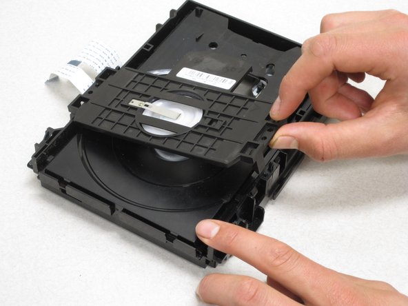

    • Remove the top cover of the disc tray by gently prying the clips off with a flathead screwdriver.
    • You will want to release one side before moving on to the other side, but do not lift the cover off until both sides are released.
  10. Repairing Samsung P241 Laser: crwdns2935265:010crwdnd2935265:01crwdnd2935265:03crwdne2935265:0 Repairing Samsung P241 Laser: crwdns2935265:010crwdnd2935265:02crwdnd2935265:03crwdne2935265:0 Repairing Samsung P241 Laser: crwdns2935265:010crwdnd2935265:03crwdnd2935265:03crwdne2935265:0

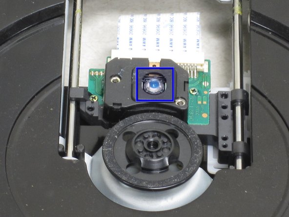

    • Very gently wipe the laser down with lens cleaner.
    • Be very careful that no excess cleaner drips down into the disc drive.
    • Use extreme caution when wiping the laser to avoid damaging it. If too much force is used, it will break or be pushed off-center and will not read the disc properly.
