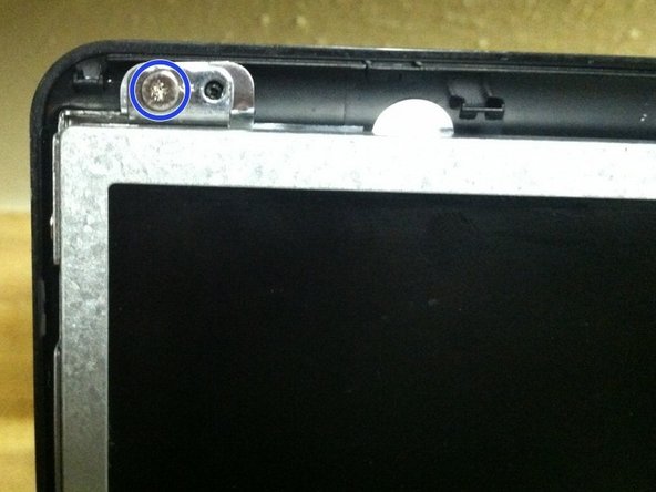

  4. Repairing Samsung NP300E5A LCD Screen: crwdns2935265:04crwdnd2935265:01crwdnd2935265:03crwdne2935265:0 Repairing Samsung NP300E5A LCD Screen: crwdns2935265:04crwdnd2935265:02crwdnd2935265:03crwdne2935265:0 Repairing Samsung NP300E5A LCD Screen: crwdns2935265:04crwdnd2935265:03crwdnd2935265:03crwdne2935265:0
    • Remove all 4 screws that secure the LCD to the back housing.
    • The innermost screw (shown in magenta) in each of the bottom left and right corners does not need to be removed.

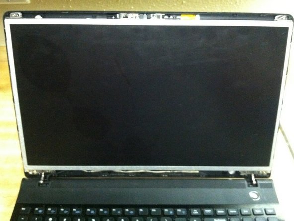

  5. Repairing Samsung NP300E5A LCD Screen: crwdns2935265:05crwdnd2935265:01crwdnd2935265:02crwdne2935265:0 Repairing Samsung NP300E5A LCD Screen: crwdns2935265:05crwdnd2935265:02crwdnd2935265:02crwdne2935265:0
    • Grab the top corners of the LCD and gently fold the LCD down until it is resting on the keyboard.
    • Do not tear the LCD cable, located along the back of the bottom of the LCD.

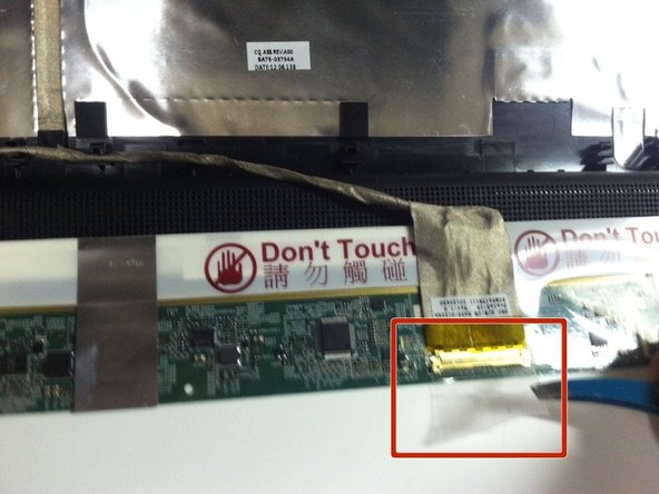

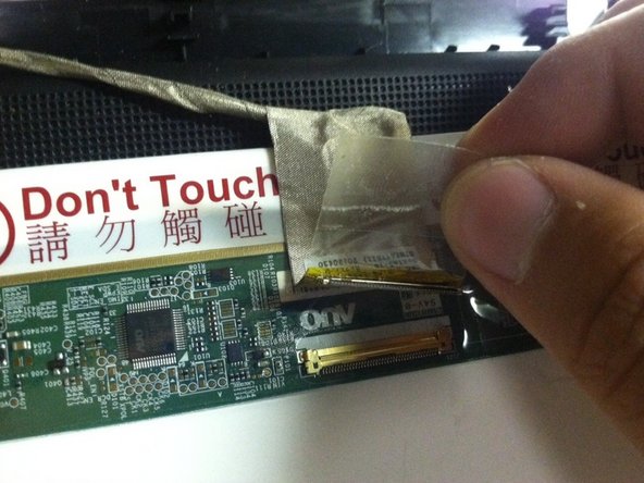

  6. Repairing Samsung NP300E5A LCD Screen: crwdns2935265:06crwdnd2935265:01crwdnd2935265:03crwdne2935265:0 Repairing Samsung NP300E5A LCD Screen: crwdns2935265:06crwdnd2935265:02crwdnd2935265:03crwdne2935265:0 Repairing Samsung NP300E5A LCD Screen: crwdns2935265:06crwdnd2935265:03crwdnd2935265:03crwdne2935265:0
    • The LCD connector is taped into its socket.
    • Use tweezers to carefully lift the clear tape holding the connector down.
    • Once you peel the tape past the gold portion of the connector, the connector should pull out easily.
    • If you purchased a replacement LCD with the metal brackets pre-attached, then you are finished. If not, continue reading!

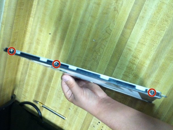

  7. Repairing Samsung NP300E5A LCD Screen: crwdns2935265:07crwdnd2935265:01crwdnd2935265:02crwdne2935265:0 Repairing Samsung NP300E5A LCD Screen: crwdns2935265:07crwdnd2935265:02crwdnd2935265:02crwdne2935265:0
    • There are two metal mounting brackets on each end of the LCD that attach the LCD to the computer housing. If your replacement screen did not come with these mounting brackets, then you will need to transfer your old ones to the new LCD.
    • There are 3 screws holding each bracket to the LCD. Remove these screws and swap the original mounting brackets to your new part.
