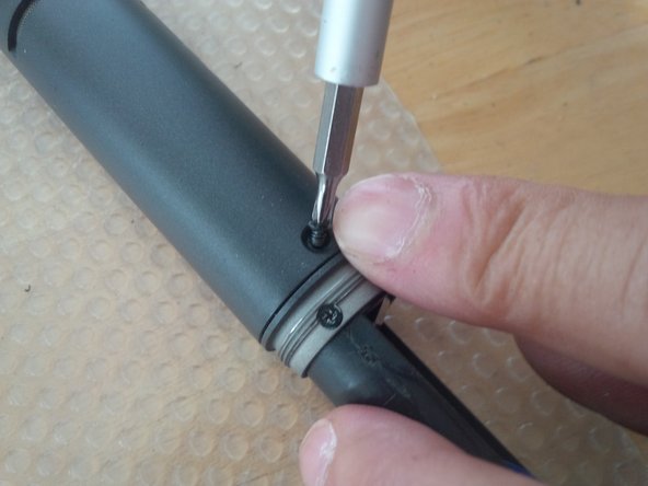

  2. Repairing Rode NTG2 disconnected/loose wiring, Remove Screws: crwdns2935265:02crwdnd2935265:01crwdnd2935265:03crwdne2935265:0 Repairing Rode NTG2 disconnected/loose wiring, Remove Screws: crwdns2935265:02crwdnd2935265:02crwdnd2935265:03crwdne2935265:0 Repairing Rode NTG2 disconnected/loose wiring, Remove Screws: crwdns2935265:02crwdnd2935265:03crwdnd2935265:03crwdne2935265:0
    • Using a Philipps #00 tip, Remove all visible screws, and set them aside in different piles/containers.

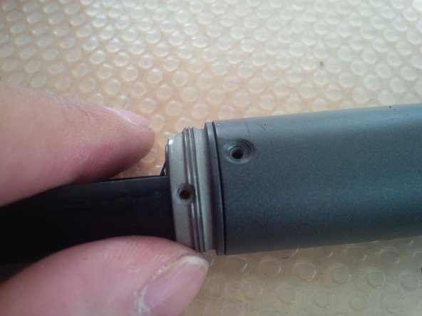

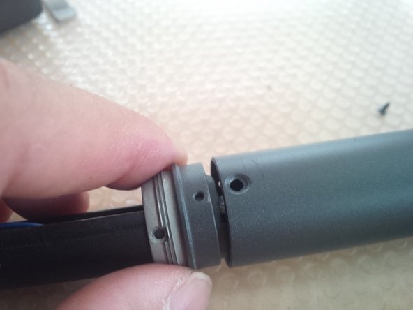

  3. Repairing Rode NTG2 disconnected/loose wiring, Unscrew Capsule/Top Tube: crwdns2935265:03crwdnd2935265:01crwdnd2935265:03crwdne2935265:0 Repairing Rode NTG2 disconnected/loose wiring, Unscrew Capsule/Top Tube: crwdns2935265:03crwdnd2935265:02crwdnd2935265:03crwdne2935265:0 Repairing Rode NTG2 disconnected/loose wiring, Unscrew Capsule/Top Tube: crwdns2935265:03crwdnd2935265:03crwdnd2935265:03crwdne2935265:0
    • Identify a flange/ring that holds the top capsule tube in place. Gently loosen and pull down, in order to release the tube.
  4. Repairing Rode NTG2 disconnected/loose wiring, Remove Capsule: crwdns2935265:04crwdnd2935265:01crwdnd2935265:03crwdne2935265:0 Repairing Rode NTG2 disconnected/loose wiring, Remove Capsule: crwdns2935265:04crwdnd2935265:02crwdnd2935265:03crwdne2935265:0 Repairing Rode NTG2 disconnected/loose wiring, Remove Capsule: crwdns2935265:04crwdnd2935265:03crwdnd2935265:03crwdne2935265:0
    • Remove capsule from head tube. Be gentle. There is a rubber gasket that holds it in place. Gently extricate the gasket, and the capsule will slide right out.

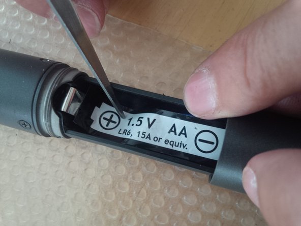

  6. Repairing Rode NTG2 disconnected/loose wiring, Check for loose wiring on bottom connector end: crwdns2935265:06crwdnd2935265:01crwdnd2935265:02crwdne2935265:0 Repairing Rode NTG2 disconnected/loose wiring, Check for loose wiring on bottom connector end: crwdns2935265:06crwdnd2935265:02crwdnd2935265:02crwdne2935265:0
    • IF no loose wires on top capsule end, then we will need to look at the bottom connector end.
    • This gets a bit tricky, as we will need to slide the round flange off the top of the tube, in order to push the bottom tube all the way to expose the connectors.

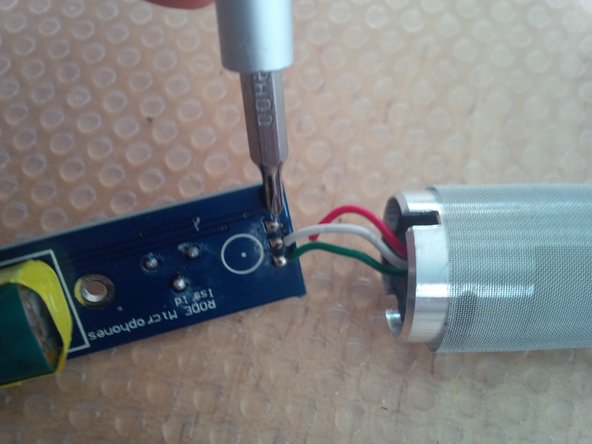

    • Locate the single silver screw holding the circuit board in place, remove that.
    • In order to do this, you will need to disconnect the capsule from the circuit board, as well as the bottom cables leading to the battery terminal.
    • Before you disconnect, take photos of the wiring for both ends of the board so you can re-solder them correctly!
  7. Repairing Rode NTG2 disconnected/loose wiring, Removing circuit board and round flange: crwdns2935265:07crwdnd2935265:01crwdnd2935265:03crwdne2935265:0 Repairing Rode NTG2 disconnected/loose wiring, Removing circuit board and round flange: crwdns2935265:07crwdnd2935265:02crwdnd2935265:03crwdne2935265:0 Repairing Rode NTG2 disconnected/loose wiring, Removing circuit board and round flange: crwdns2935265:07crwdnd2935265:03crwdnd2935265:03crwdne2935265:0
    • After disconnecting the wires to both mic capsule and connectors, gently lift up the circuit board from the housing.
    • Slowly slide the flange off the mi capsule end of the housing.
    • Slide the bottom tube in the same direction, until bottom connectors are exposed. Check for loose/broken wiring.
    • Re-solder connectors as needed.
    • Reverse the process, and return both the bottom tube AND the flange BEFORE re-soldering connector leads back to circuit board.
    • Resolder all wires back to Circuit Board, once the bottom tube and flange have been slid back into place.
