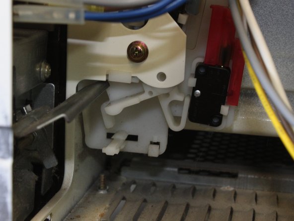

    1. Repairing Quasar Microwave Door Handle, Repairing Quasar Microwave Door Handle: crwdns2935265:05crwdnd2935265:01crwdnd2935265:02crwdne2935265:0 Repairing Quasar Microwave Door Handle, Repairing Quasar Microwave Door Handle: crwdns2935265:05crwdnd2935265:02crwdnd2935265:02crwdne2935265:0
      • Observe the lever mechanism found just behind the door handle, inside the microwave.
      • The plastic lever should be above the metal lever. If the metal lever is above the plastic lever, this is why the door will not open.
      • In this picture, the metal part is ABOVE the white plastic part. The white part needs to be lifted to open the door so when the door lever is pressed, the metal part rises, and the plastic part stays in place.

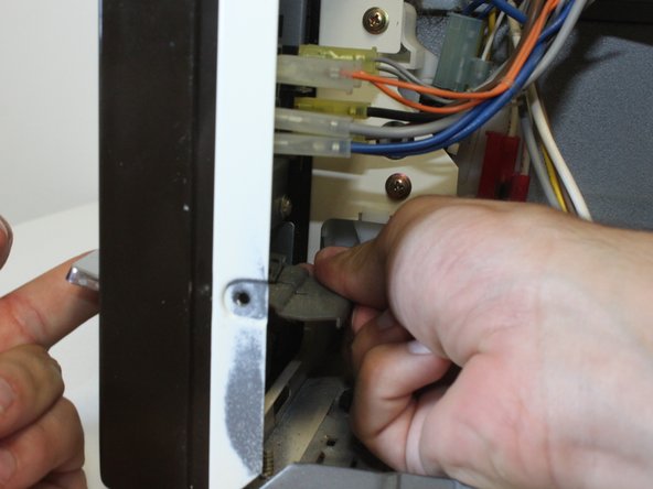

    2. Repairing Quasar Microwave Door Handle: crwdns2935265:06crwdnd2935265:01crwdnd2935265:03crwdne2935265:0 Repairing Quasar Microwave Door Handle: crwdns2935265:06crwdnd2935265:02crwdnd2935265:03crwdne2935265:0 Repairing Quasar Microwave Door Handle: crwdns2935265:06crwdnd2935265:03crwdnd2935265:03crwdne2935265:0
      • Lift up on the outside lever.
      • Push up on the white plastic piece.
      • Push metal bar down, snapping the white plastic piece above it.

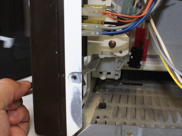

    3. Repairing Quasar Microwave Door Handle: crwdns2935265:07crwdnd2935265:01crwdnd2935265:02crwdne2935265:0 Repairing Quasar Microwave Door Handle: crwdns2935265:07crwdnd2935265:02crwdnd2935265:02crwdne2935265:0
      • This is how the fixed mechanism should look.
      • Press the button and enjoy your newly fixed door!
