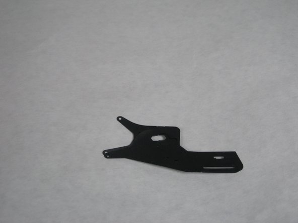

  11. Repairing Polaroid One-Step 600 Shutter: crwdns2935265:011crwdnd2935265:01crwdnd2935265:03crwdne2935265:0 Repairing Polaroid One-Step 600 Shutter: crwdns2935265:011crwdnd2935265:02crwdnd2935265:03crwdne2935265:0 Repairing Polaroid One-Step 600 Shutter: crwdns2935265:011crwdnd2935265:03crwdnd2935265:03crwdne2935265:0
    • To replace the shutter pieces in the camera, first make sure they are in the proper order.
    • The shutter piece at the bottom of the first picture belongs on the bottom.
    • The shutter piece in the middle of the first picture goes in the middle (second picture).
    • The shutter piece at the top of the first picture goes on top (third picture).

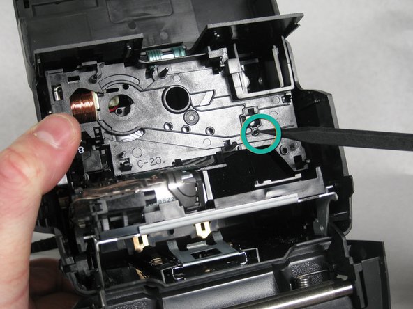

  14. Repairing Polaroid One-Step 600 Shutter: crwdns2935265:014crwdnd2935265:01crwdnd2935265:02crwdne2935265:0 Repairing Polaroid One-Step 600 Shutter: crwdns2935265:014crwdnd2935265:02crwdnd2935265:02crwdne2935265:0
    • CAUTION: The next two steps are incredibly difficult!
    • First, you must align the tab (circled) with the slot (rectangle).
    • Do not put pieces together until after reading the next step!!!

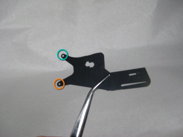

  15. Repairing Polaroid One-Step 600 Shutter: crwdns2935265:015crwdnd2935265:01crwdnd2935265:03crwdne2935265:0 Repairing Polaroid One-Step 600 Shutter: crwdns2935265:015crwdnd2935265:02crwdnd2935265:03crwdne2935265:0 Repairing Polaroid One-Step 600 Shutter: crwdns2935265:015crwdnd2935265:03crwdnd2935265:03crwdne2935265:0
    • REMINDER: This step is very difficult and may require multiple attempts.
    • Align teal and orange circled tabs from the first picture with the respective teal and orange holes in the shutter pieces.
    • After the shutter mechanism is placed into the camera, make sure all three shutter pieces are attached correctly.
    • NOTE: When correctly attached, the shutter pieces will slide in opposite directions when the shutter mechanism is rotated.
    • To finish putting the Polaroid back together, follow steps 9 through 1 in reverse.
