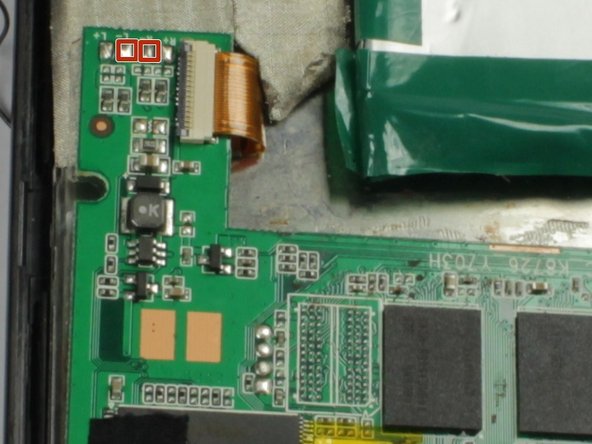

  3. Repairing Pioneer R1 Speaker Cables: crwdns2935265:03crwdnd2935265:01crwdnd2935265:02crwdne2935265:0 Repairing Pioneer R1 Speaker Cables: crwdns2935265:03crwdnd2935265:02crwdnd2935265:02crwdne2935265:0
    • Solder the black cable of the left speaker to the nodule marked L+ on the motherboard.
    • Do not allow solder from one nodule to touch another nodule. This will cause the speakers to malfunction.
    • Solder the black cable of the Right speaker to the nodule marked R+ on the motherboard.
    • Solder the red cable of the left speaker to the nodule marked L- on the motherboard.
    • Solder the red cable of the right speaker to the nodule marked R- on the motherboard.
