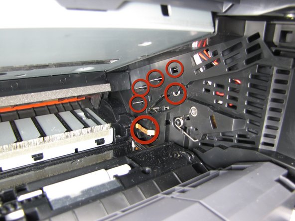

    1. Repairing Paper Jam, Repairing Paper Jam: crwdns2935265:03crwdnd2935265:01crwdnd2935265:02crwdne2935265:0 Repairing Paper Jam, Repairing Paper Jam: crwdns2935265:03crwdnd2935265:02crwdnd2935265:02crwdne2935265:0
      • DO NOT TOUCH the electrodes on the right inner wall of the printer. Touching these electrodes can cause electrical damage to the printer.

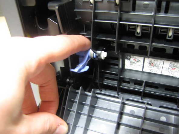

    6. Repairing Paper Jam: crwdns2935265:08crwdnd2935265:01crwdnd2935265:03crwdne2935265:0 Repairing Paper Jam: crwdns2935265:08crwdnd2935265:02crwdnd2935265:03crwdne2935265:0 Repairing Paper Jam: crwdns2935265:08crwdnd2935265:03crwdnd2935265:03crwdne2935265:0
      • In front of you will see two blue tabs, one on the left and right side.
      • First, push the top part of the tab in until the bottom part of the tab lifts up.
      • Grab onto the bottom part of the tab.
    7. Repairing Paper Jam: crwdns2935265:09crwdnd2935265:01crwdnd2935265:02crwdne2935265:0 Repairing Paper Jam: crwdns2935265:09crwdnd2935265:02crwdnd2935265:02crwdne2935265:0
      • Once you have a firm grib of both the right and left tab, lift both tabs up and towards yourself.
      • The fuser cover, which the tabs are connected to, does not come completely out of the printer because it is attached to the bottom by a hinge.

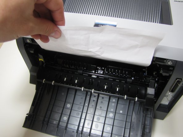

    8. Repairing Paper Jam: crwdns2935265:010crwdnd2935265:01crwdnd2935265:03crwdne2935265:0 Repairing Paper Jam: crwdns2935265:010crwdnd2935265:02crwdnd2935265:03crwdne2935265:0 Repairing Paper Jam: crwdns2935265:010crwdnd2935265:03crwdnd2935265:03crwdne2935265:0
      • If jammed paper is visible, grab onto the top of the paper and pull up until completely removed from printer.
      • Jammed paper may require an excess amount of force to be removed from printer.
