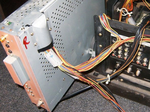

    • The antenna coax cable as well as other device connect directly to the DM module which is enclosed in a metal case.
  2. Repairing Mitsubishi WS-65511 Blinking green light fuse replacement: crwdns2935265:02crwdnd2935265:01crwdnd2935265:03crwdne2935265:0 Repairing Mitsubishi WS-65511 Blinking green light fuse replacement: crwdns2935265:02crwdnd2935265:02crwdnd2935265:03crwdne2935265:0 Repairing Mitsubishi WS-65511 Blinking green light fuse replacement: crwdns2935265:02crwdnd2935265:03crwdnd2935265:03crwdne2935265:0
    • Disconnect the wiring coming off the DM board to the main chassis. On this TV there were four separate wiring harnesses: DA,VA,DB and PF. These markings are not of importance to this repair. But they all are clearly marked on the connectors as well as the logic board they connect to. This will help to identify their proper position for the re-assembly.
    • Undo the two screws that hold the plastic cover to the DM board.

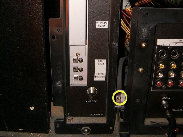

    • To the bottom right is a screw that connects a ground strap and holds the board to the chassis, undo that.
    • With all the connector disconnected, the ground strap removed, pull the DM board carefully from the chassis. Some models have a small tab stop that you must push down to release the board.

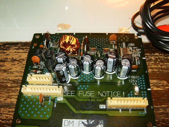

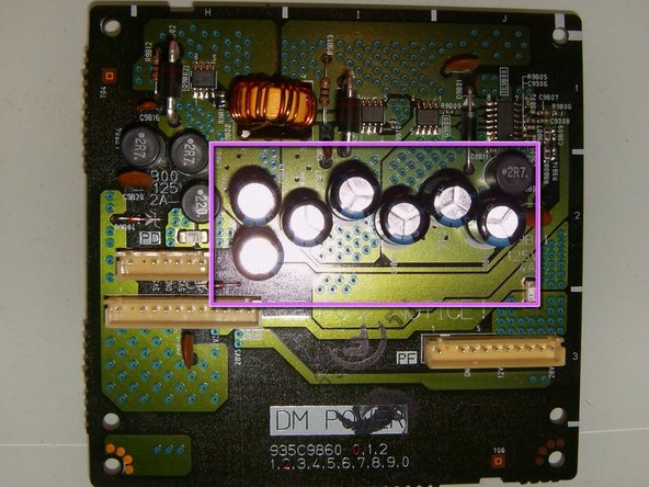

    • This board has 7 1000uf 16Volt capacitors. These are the ones that have a tendency of failing. Inspect those for bulging tops as well as leakage. In this case, one capacitors was sligthly bulged.

    • Unsolder all the capacitors and remove them. In this repair a 30watt soldering iron and solder sucker was used. The solder sucker can be substituted with soldering wick.

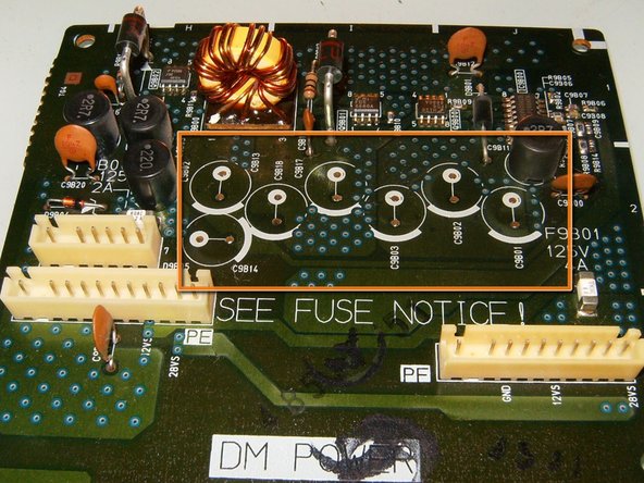

    • Solder all the capacitors in their respective places. On the logic board, where the capacitors are located, is an outline of a circle with one part of the circle being heavier. It corresponds with the negative lead of the condenser.
    • Once all the capacitors are replaced, double check the board to make sure everything is properly mounted.

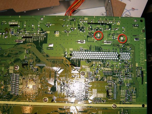

    • While the board and the DM power module are accessible check the SMD fuses for continuity. There are two on the daughter board. In this case, the fuses had continuity and were functioning.
    • The main PCB has two fuses on the underside. In order to get to it, one will have to disassemble the module further. This was skipped in this repair.
