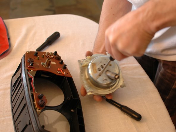

  4. Repairing Mercedes W123 Odometer: crwdns2935265:04crwdnd2935265:01crwdnd2935265:01crwdne2935265:0
    • Remove the screws holding the tachometer/clock assembly to the back of the cluster. There are three shown here; a fourth is obscured behind the fixer's hand.
    • You may also need to remove the rheostat that dims the instrument lights.
  5. Repairing Mercedes W123 Odometer: crwdns2935265:05crwdnd2935265:01crwdnd2935265:01crwdne2935265:0
    • You will now be able to carefully lift the tachometer/clock assembly out of the cluster. Set it aside someplace safe. Do not set it face down, on the needles.

  7. Repairing Mercedes W123 Odometer: crwdns2935265:07crwdnd2935265:01crwdnd2935265:02crwdne2935265:0 Repairing Mercedes W123 Odometer: crwdns2935265:07crwdnd2935265:02crwdnd2935265:02crwdne2935265:0
    • You can now lift the speedometer assembly out, carefully. Note that there are wires that cross behind the gauge face; you will need to clear these wires to remove the gauge.
  8. Repairing Mercedes W123 Odometer: crwdns2935265:08crwdnd2935265:01crwdnd2935265:01crwdne2935265:0
    • Now, remove the single screw that holds the black plug on the back of the speedometer assembly. With the screw removed the plug pulls out of a slot.
